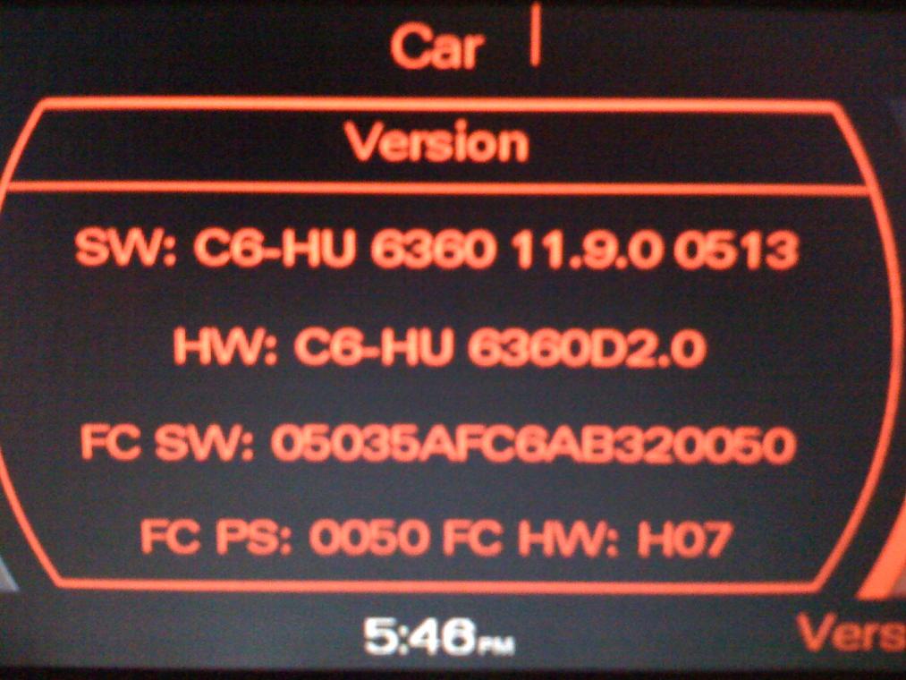

The MMI had a few bugs with not updating the satellite radio stations, losing surround settings and sometimes not automatically linking with my bluetooth phone. Audi had the car for a day and updated the MMI computer software. Audi has a TSB on this issue as well.
Kevin, can you take a look at this pic and let me know if you can tell what the heck my version type is? I'm having trouble with my XM stations so I thought this would be a good place to look.

You are on version 11.9. There is a rumor that version 46 has just been released. Obviously your current software is a little out of date. It was not until version 33 that most of the bugs were worked out.

Thanks man. I'm heading straight to the dealership to at least get 45 I guess.
