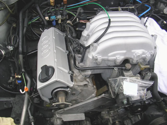

I still can't believe I got to this point but the camera doesn't lie :
Bank 1:

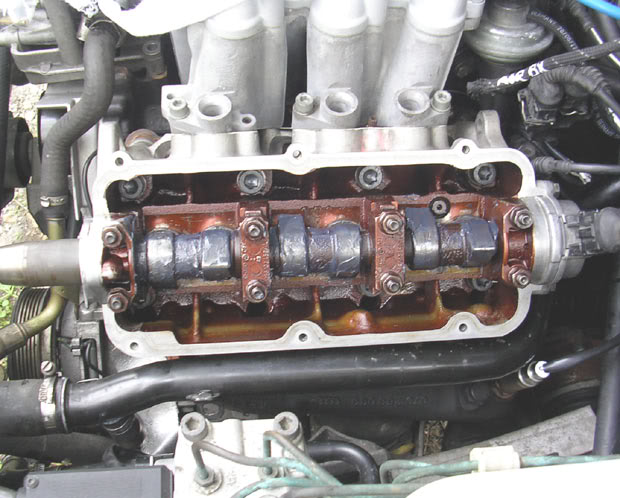

Bank 2 - Assembly Lube:

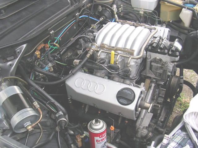

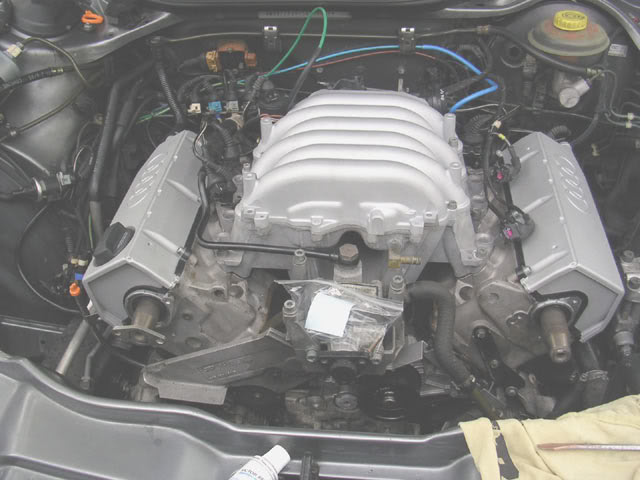

Fuel Rail back in:

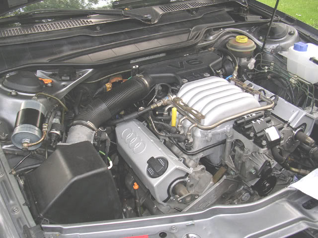

Air Intake back in:
