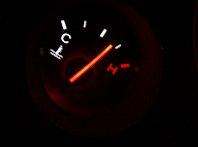

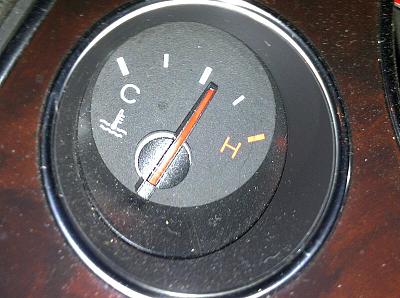

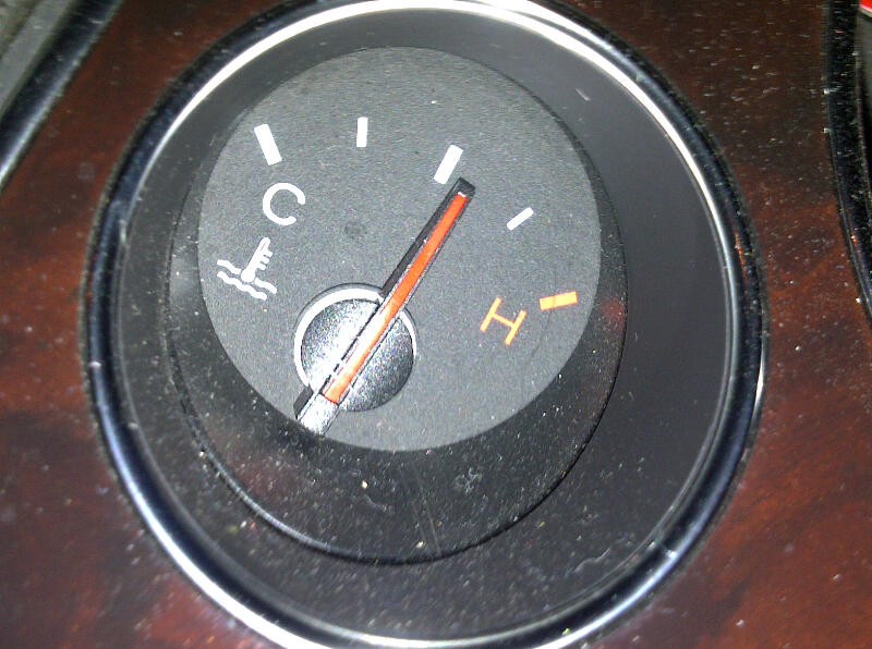

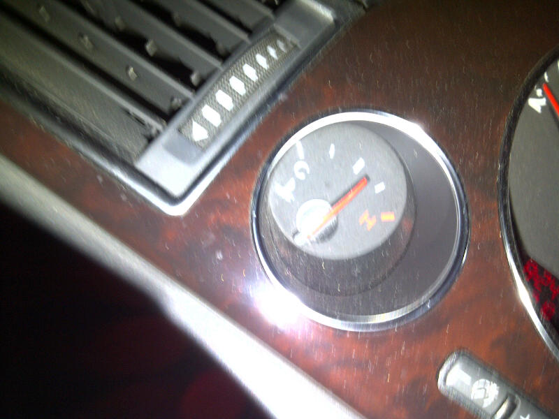

Reading the forums sounds like have a thermostat issue. Here are some pictures of the temp. It goes up and down like a yo-yo. No coolant loss at all, once very nearly hit the red zone, but backed off. Strange?
I have had the car overheat 6 months ago when I had a hole in the expansion tank. So I have seen the steam and pouring out the red overheating sign flashing in the dash.
But the needle going from 1/2 to 3/4 back to 1/2 way, has me going crazy, any idea where it's supposed to stay under normal operating conditions? (the flash did not fire in one the pics)

Thermos are notorious on the A8s for failing and R/R a thermo is 3/4 the way to a new timing belt - if you are close to belt change time, bite the bullet and do the entire job.
But, if you had a coolant leak in the past and have had the bouncing temp since, I would suspect a pocket of air in your coolant system, reference your Bentley manual to bleed the air out of the system (you do have one, dont you?

A really inconsistent needle can also be a bad coolant temp sensor.
If you have a bad thermostat and temp goes back down, it should do it for a logical reason...higher rpms and/or heavy heater use will temporarily send the temp down some (high heat, high fan speed is agreat emergency cooldown method...common used used by racers as an extra radiator). But if the temp needle drops back for no apparent reason, it may be the sensor...or, in rare cases, an intermittently sticking thermostat... possible but not likely...they usually stay stuck open or closed.

I checked the Bentley manual, and bleed the air out of the cooling system, not a huge amount, but made a big difference on temp needle, staying around the half way mark now. Easy fix I hope. I shall monitor for the next week.
