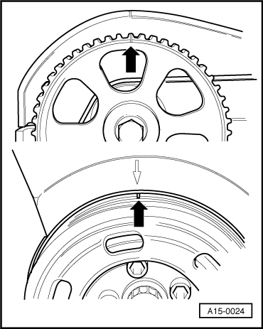

Honestly, i have no idea because i was never trained to look for any timing marks. The only audi engines with timing marks (at least for the timing belt) are 4 cylinder models. Like this
Size:  18.6 KBThats for a 1.8T engine.
