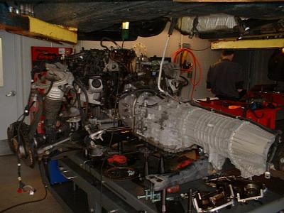

If you get a chance, you should see what it takes to change the engine in a Q7. Entire front subframe, suspension, steering, brakes, engine and trans get dropped out the bottom of the vehicle. Kind of like this (this was a VW Touareg I was doing timing chains on. The chains are on the rear of the engine).

Thanks Aspen79 thats really great information. I appreciate your willingness to share it. The thumbnail reminds me off the horror of owning an old porche 928...every time it went to the shop they had to remove the engine...layer by layer...
