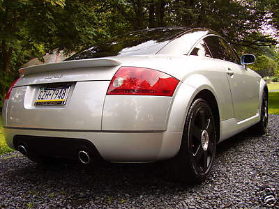

Hey, I just picked up a 2001 TT 180 Quattro last week. It has a forge diverter, GIAC chip and 225 exhaust. It has a VDO boost gauge but the boost only goes to 5 psi then seems to taper to 4. It has a CEL but seems to boost fine. Any ideas on what could be wrong? Thanks
