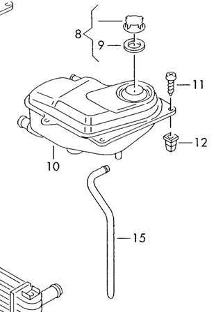

Hey, what is this? It's coming off the coolant expansion tank. Doens't look like it goes anywhere?
Your tank is in a different spot than the 1.8T cars. Where does it attach to the coolant tank? Is it an overflow hose so coolant doesn't splash on the ABS controller?
It doesn't look right. I looks like it's been cut on the end.

Is the hose #15 in the picture? If so, it's just a drain hose.
