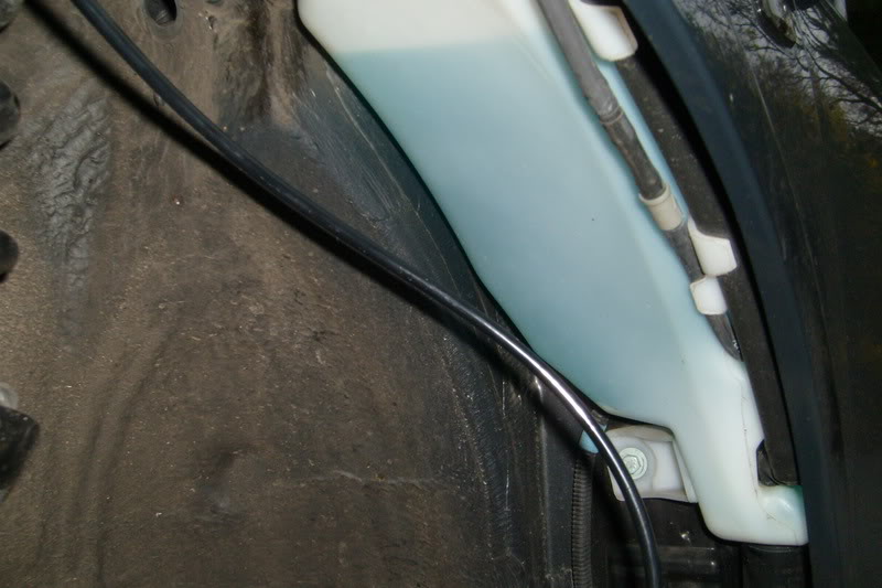

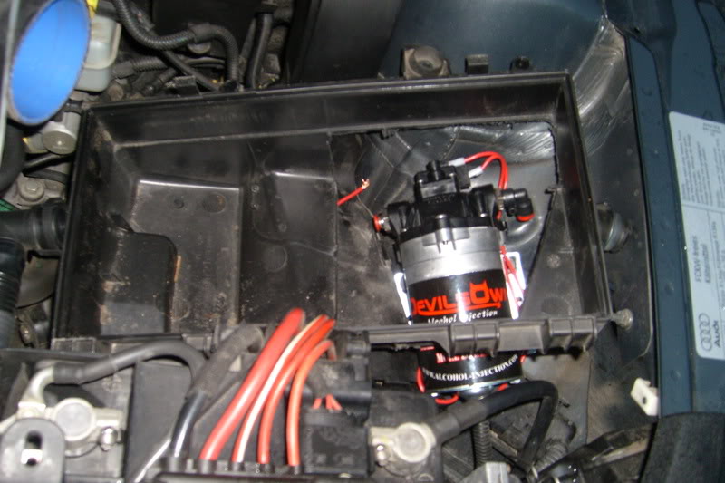

The real challenge to all this is WHERE to mount stuff. I explored a little tonight and have probably settled on where to mount the pump. I keep a gallon of washer fluid in the car anyway, so I'll use the washer tank. Here are some preliminary pics. I didn't get all the way there yet because I have to go to work tomorrow and didn't want to be up till midnight. However, come Saturday, I'm gonna have some fun.
Washer Tank with Wheel Liner Removed

Mounting Location for Pump with Airbox Removed
Another view of the Pump Location
Water Line inside Wheel Well to Engine Compartment and Pump
Water Line running to Washer Tank

Modified Airbox to make room for the Pump
Side View of Airbox
View of Pump with Airbox Installed
This is about the only place to mount the pump. If anyone has a better location, please post it up. As you know, it is really tight in our engine compartment. I have no idea where you'd mount a separate tank. I'll post more pics as I make progress.
