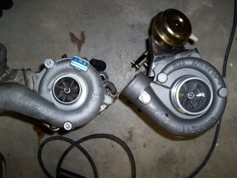

so this turbo here labelled as a t3S60 is in fact just a regular t3 60 trim.
this is comparo of k03 vs supposed T3S60.

that is technically a t3 60trim but even other retailers call it a t3s60. Its not really a much of a differnce. Both are t3 housings and smaller 60trim housings. The only differnce is the bearings used on the Turbonetics which makes it cost ~$900.

but it will still be rated for 33lbs corrected arflo and still flow up to 350 hp?
posted before hitting refresh ... im refferingthe the garrett here.

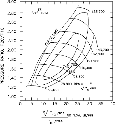

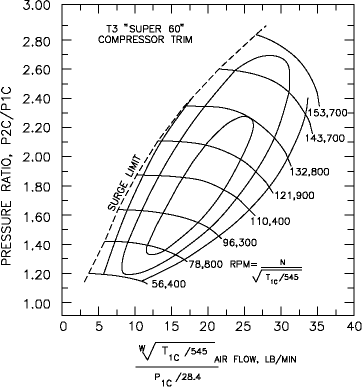

ok here are the 2 comp maps... i guess now i should be looking at the t360 not the s60... i do notice the difference in the top end with the two maps.

BTW, the left map is for a t3 s50
