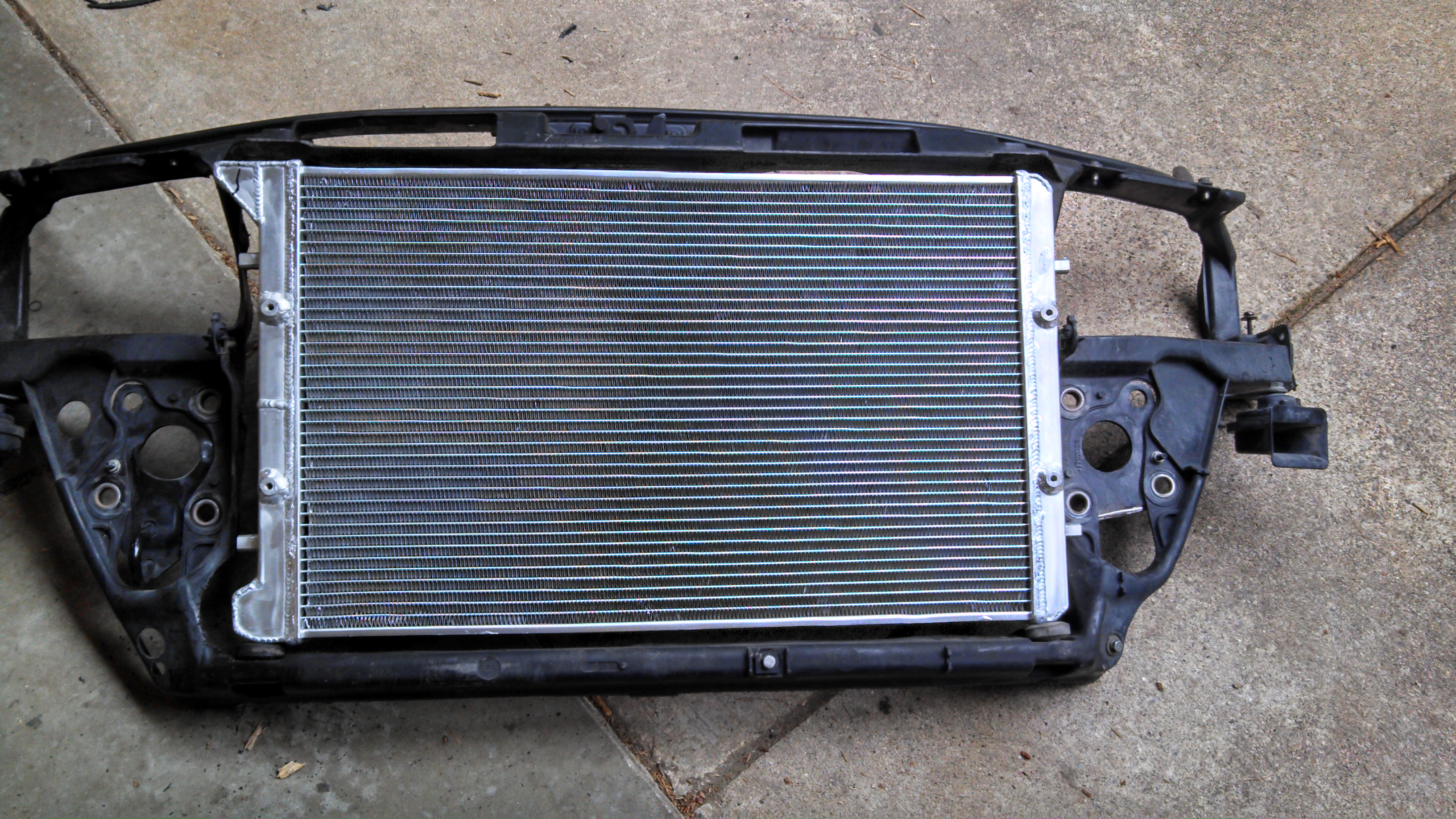

Custom radiator had to be fabricated, but I knew that going in. Bought an Ebay aluminum radiator for $150 and had a buddy of mine help cut and weld it until it fit.

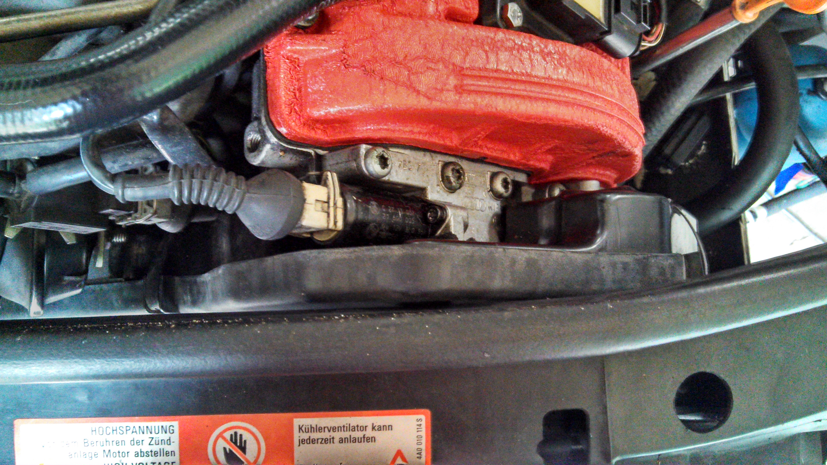

We filled it with water tonight and ran it to look for leaks. No coolant leaks, but we have an oil leak on the driver head near the cam chain tensioner. I replaced the gaskets when I had the cams out, but I think it may be seeping near the black solenoid. Anyone know if there is a gasket between the aluminum body and the black solenoid?

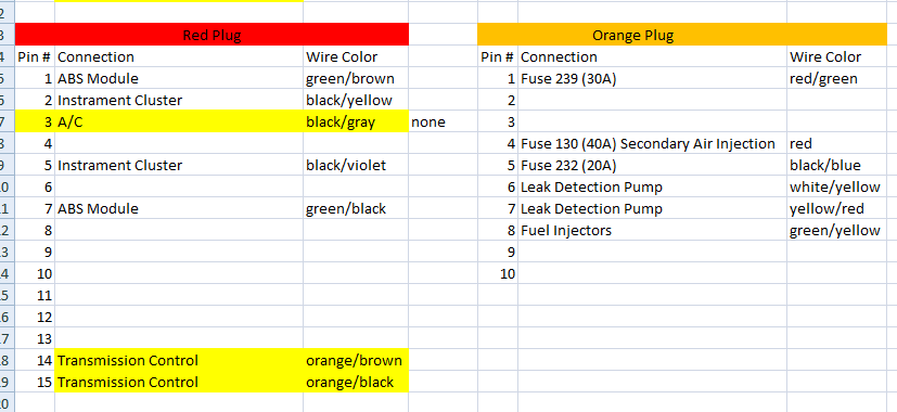

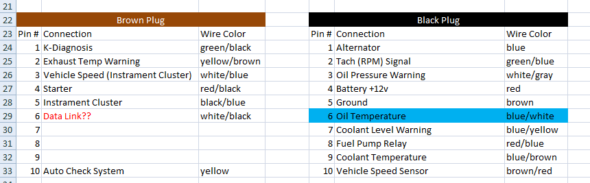

For power to the ECU, I'm using the stock body plugs in the plenum. I went through each pin for both engines. Everything was the same, save for some warning lights and gauges. I added the white plug for the throttle pedal and we were running.

Ok that's basically what I had to do too, though I do remember having to connect one of the black/blue wires to a switched 12v source, the ECU wouldn't turn on without it. Your ECU uses a J271 (ECU power relay) right? If you turn the key to off with a scan tool connected to the ECU, does it lose communication instantly?
Also, look into pin 4 of the black connector. In my case the interior side wire to that pin was significantly thinner than the corresponding pin in a DBW car, 1mm vs 2.5mm I think. I only noticed this because I cut the body plugs off a DBW car to compare.

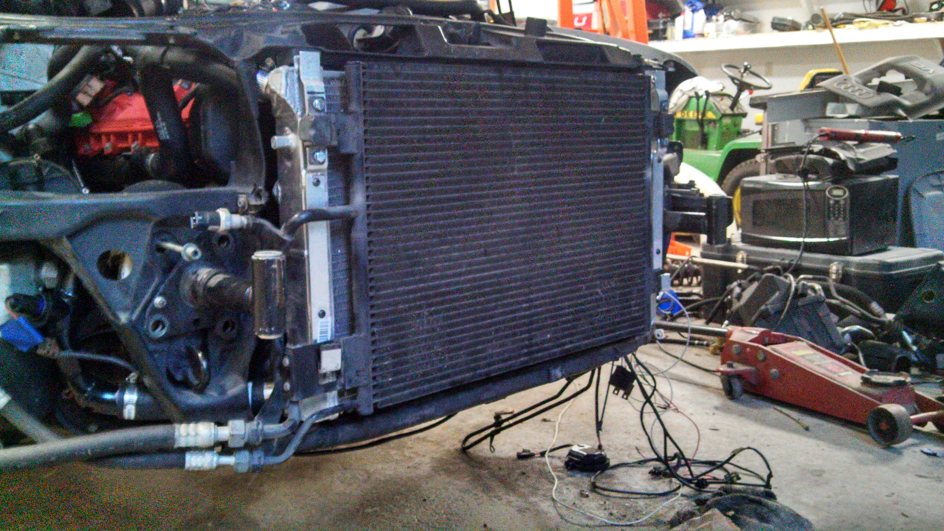

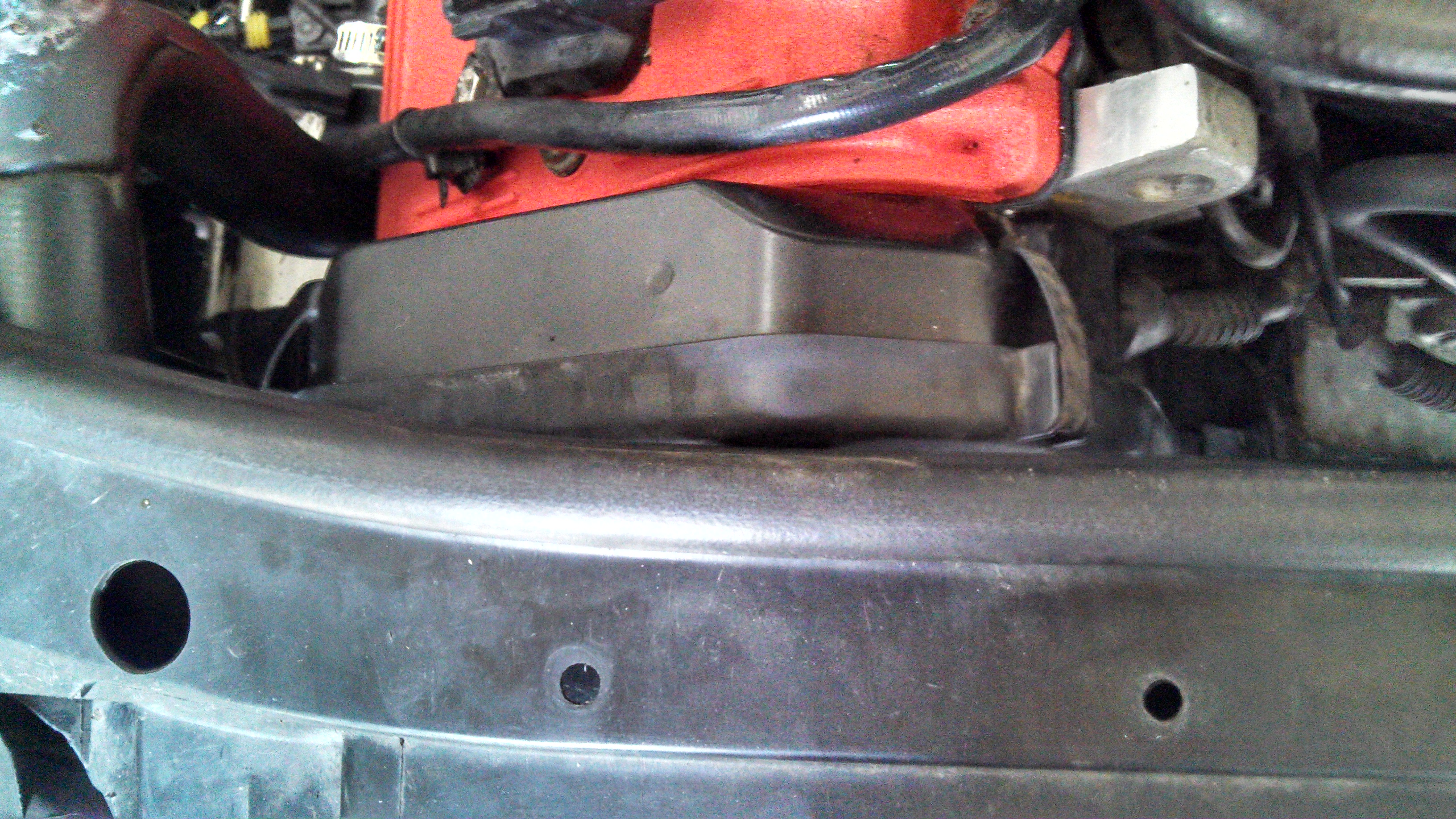

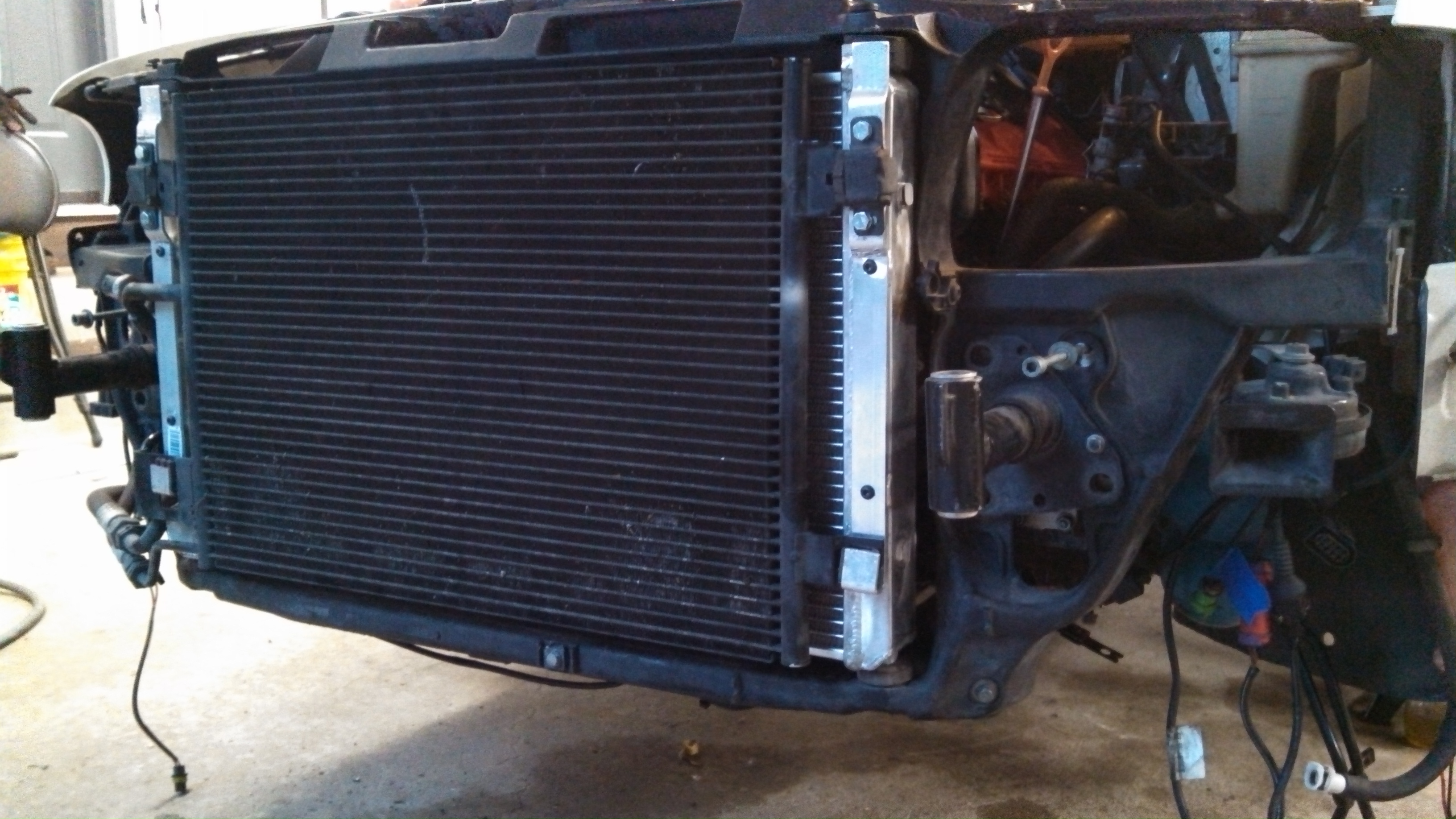

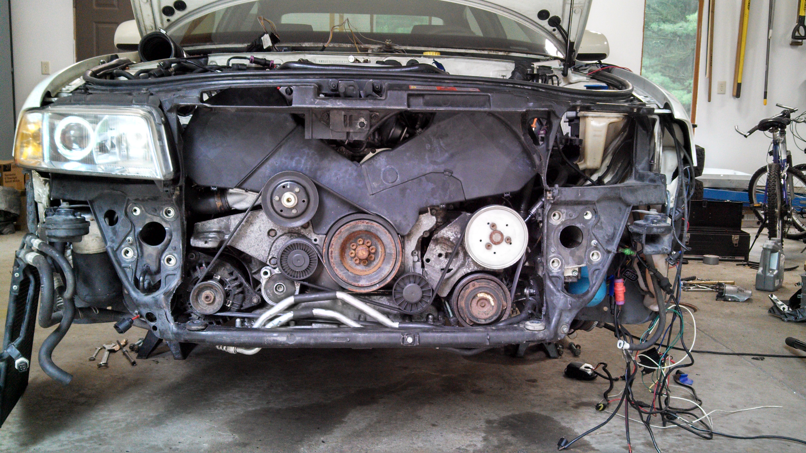

I didn't get much done today as I wasn't feeling very well. I did manage to get the condenser mounted to the radiator though. I also got my oil leak sorted out. There is an o-ring between the black solenoid and the aluminum body of the cam chain tensioner. I cleaned it all up and added a little RTV. No more leaks.
