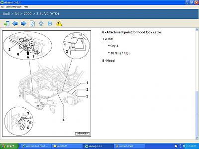

heres the ebahn manual of the hood latch

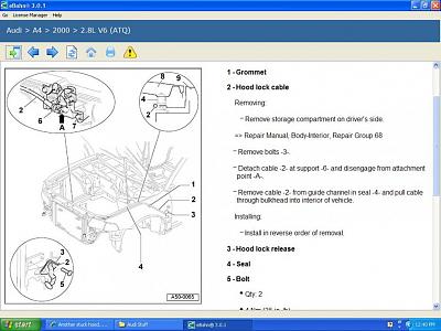

page 2 of ebahns

Thanks for the diagrams but i fear it didn't shed much light for me.
