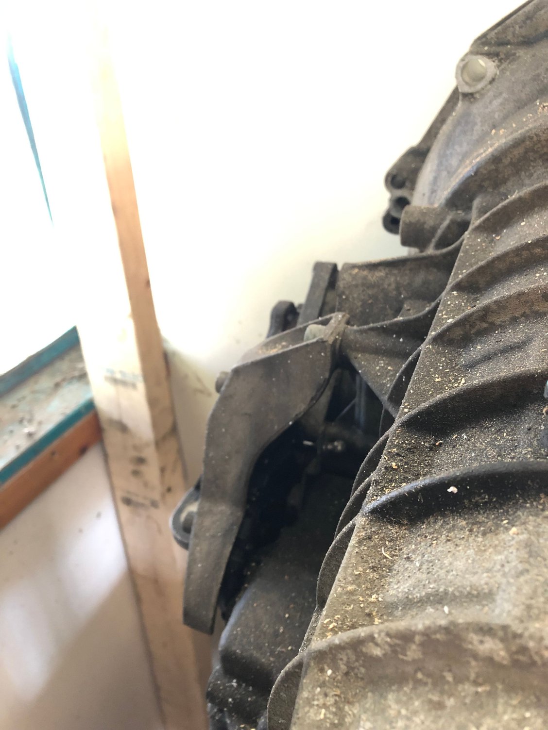

The switch is hidden underneath the left side trans mount.
With the mount taken off.

Thanks, i got under the 2.8 quattro today & found it. When sitting in the car its on the right hand side of the transmission, under that trans mount. We drive on the left in NZ so the drivers seat is on the right hand side. Im not sure what things they change to do this other than the obvious drivers seat/steering wheel/ brake master cylinder & battery.

And yeah, its not that easy to get too.

On my 2.4 litre 1998 wagon, it's on the left hand side, seen when sitting in the car. It's also the round plug.
transmission AG5 01V TCM# 8D0927156R i got the switch & replaced it ( under that mount ) it is a bit of work, but do it methodicaly & you will get there.
