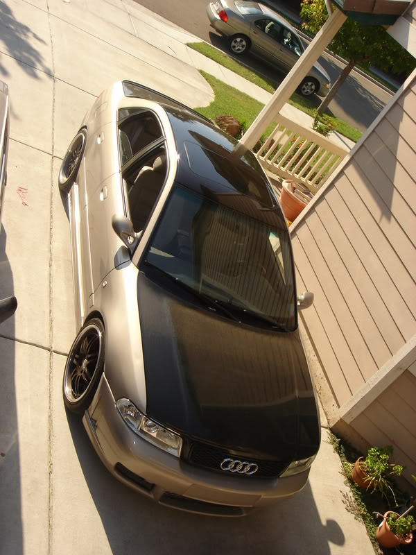

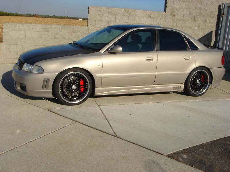

Fred, love your car.
I cant tell if the car is really gold, or just a hue from the picture? What is the true color? if its really gold with he black hood, well, I love the combination.

Thanks,
The color of the car is Melange which could best be described as a champaign color. A friend of mine who did the sig for me tweaked and filtered the color a little .... .... but it does change a lot according to the sunlight.
Here is a normal picture of the car:
