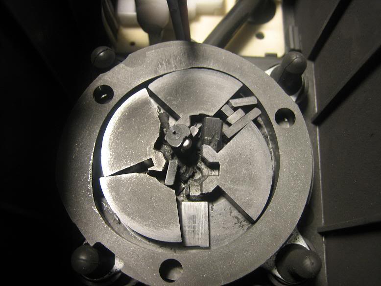

I wa able to find an a4 in a junk yard and got the pump for only $4 (just cause no one knew what it was)
This is what the broken one looked like.

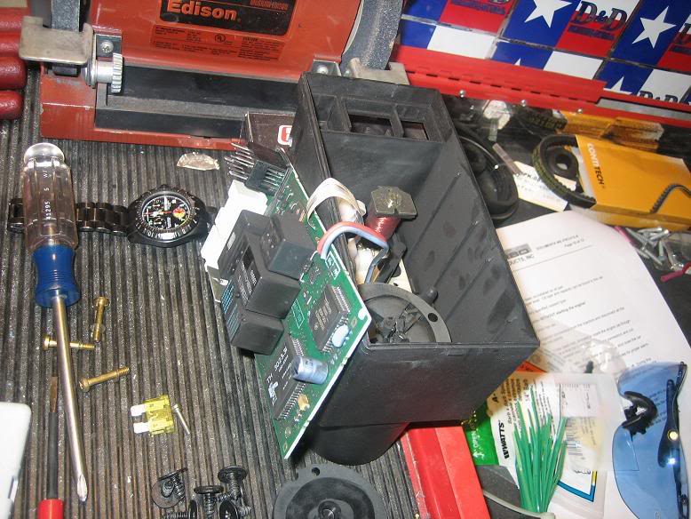

This is where it is in the module:

yeah mine looked axactly the same. the only problem is im trying to find an a4 in a junkyard around here. i will keep searching

Nice pics your eminence.
I wonder if the module just needs better shock absorption. Just a theory.

I think it;s because they make them out of some sort of graphite type material. It's just too brittle.
