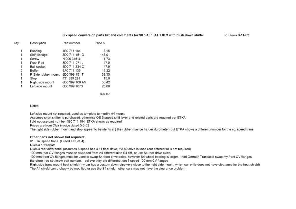

Where would I go about finding a used tranny? I looked on ebay to no avail and I'm at a loss to think of anywhere else to find one..
anyway, things like a boost gauge/DV are a given haha..
