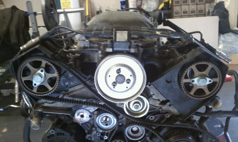

Ok I can't figure out how to get a pic up here from photobook so here's the link. Sorry for the trouble.
http://s349.photobucket.com/albums/q..._5629756_o.jpg
Obviously my engine is out of time, which means I need to pull the heads off again. When I do, how should my valves be positioned, particularly the passenger's side (I believe the driver's side is set right).

If you're going to pull the head to do this, you're playing it safe, and that's good. Trying to rotate the cam sprocket with the head attached might cause the valves to hit the pistons. When you pull the head, all you need to do is get the oval bracket on the cam sprocket level, with the larger of the two holes in it toward the center of the engine, just like the driver side bracket is positioned. See how the oval bracket has the small hole and large hole and the larger one is toward the center of the engine? Just position your cams such that the bracket on the passenger cam sits the same way (in essence, a mirror image). Long as you have it close before you reinstall the head, you can make minor adjustments to it to level the bracket. This will time the cams properly. Then both heads will be set, and if I remember right, your crank is already positioned correctly (notch in the crank pulley aligns with the timing mark on the lower cover). If that's the case - crank is set to the mark, and cams are both set as described - you can put the belt on and tension it, and reassemble the car.

what devil said. it should look like this
