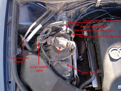

I also took the MAF sensor out and cleaned it but I didn't look like it was dirty or that any oil came off of it. I haven't driven it enough to see if that helped the fuel economy or not but I'm a little doubtful. I noticed that a vacuum check valve is broken around part of the casing, and I thought that this may have caused a vacuum leak but the way the direction on the check valve is, its just blocking the line. There is a line that I believe runs from the back of the car to the charcoal canister, and from there it connects to the purge control. Off of the purge control is a Y hose, on one end there is vacuum but on the other end is the broken check valve which stays closed because there is no vacuum from the line on the other side. I have taken and labeled a picture so its a little clearer what Im trying to say. As it is right now that check valve isnt doing anything except blocking 1 end of the Y, so what is the purpose of it. Is it supposed to be the other way around or is there supposed to be vacuum from that line. I couldn't see where the line was going to. Also what is that box that I labeled with a ?

The item with the '?' is the ignition ignitor module, if I remember correctly. They commonly go bad.
It might be a good idea to buy a service manual, probably something more than a Haines, but it might cover what's needed. Replacing the check valve would also be wise, if failed.

Anybody know if that check valve is in the right direction or if that line is supposed to have vacuum? There is no check engine light on but when I start the car it says "Service: Insp" Is that just a maintanence thing or is it indicating a problem?
