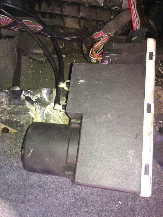

our locks are operated via vacuum. That's the vac pump. If its making noise but your doors still don't lock/unlock, you've got a big vac leak someplace.

this is the pic
lol funny you should mention vac leak, im getting codes for system too rich, based on some of these posts, i think leak check is in order.
Is this it?

there is only a leak if the pump continues to run, if it runs for longer than like 5 seconds you shouldnt have a leak. check to see if it was wet at sometime, i've had nothing but trouble in my car with this thing. i went through a few used ones before i found out that the catch in the drivers door was bad and causing all of my problems. good luck with chasing ghosts cause thats what its been like for me.

Do you get the same behavior when you use the lock/unlock buttons on the driver's door?
If so, the pump you have in your pic might be bad. I had to replace mine a couple of months ago for the same behavior you're experiencing now.
