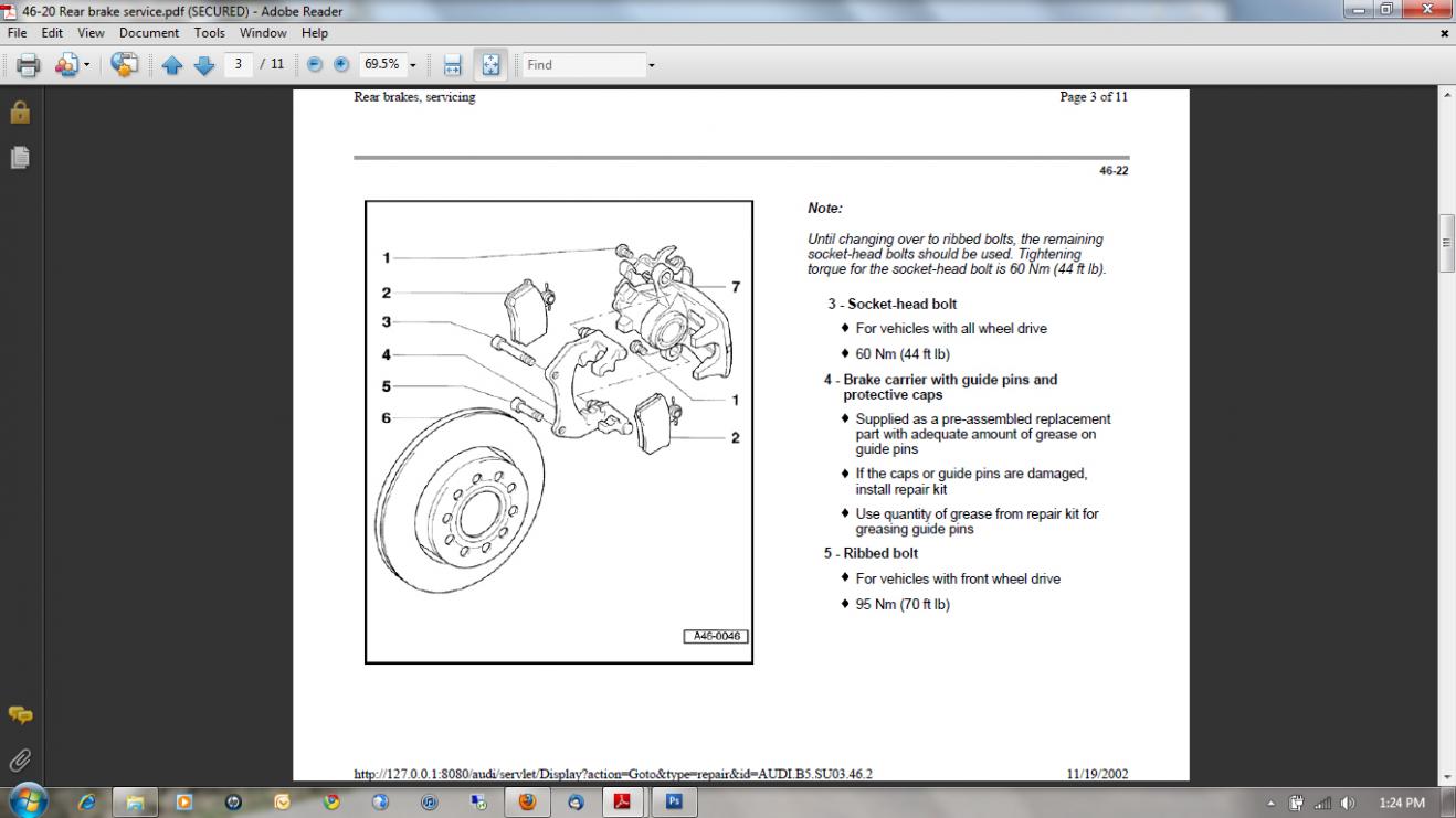

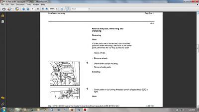

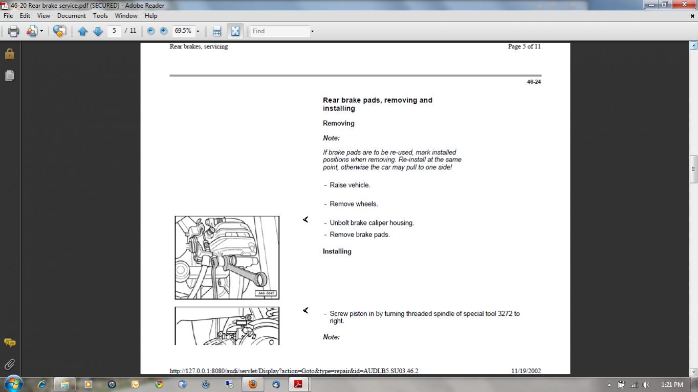

From: Longmont, CO
you will need two wrenches. A pretty thin 15mm and a 13mm wrench or socket. the 15mm will hold the head of the carrier bolt and the 13mm unbolts another.
I hope the files will help a little.
