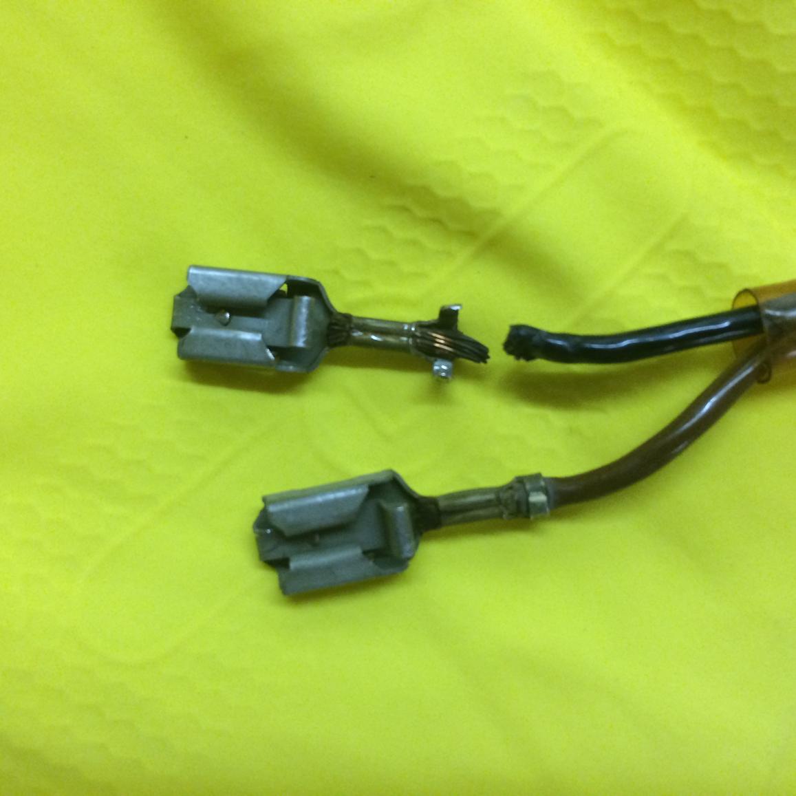

Problem resolved: it was the fuel pump circuit, specifically a broken wire in the fuel tank. The car quit totally on Saturday, which in a way always makes the troubleshooting easier. After pulling the pump last night, it was obvious that one wire had a break, and in fact with a tug it came apart. Some terminal soldering and I'm back on the road!
A final update: after fixing the broken wire, that problem was gone, but now the car took as much as five or six seconds of cranking to start after not being driven for a while. Using VAG-COM to run the pump for that time instead made the engine start right up, so I suspected a leaking fuel hose in the tank. Tightening the hose clamps did nothing, so the other night I pulled the pump again and replaced the 20 year-old plastic hose with a foot of Gates submersible fuel line, which is about $30/foot at NAPA. This completely solved the long cranking issue, and I think the old plastic was just too hard to seal after being pulled off of the pump a couple of times.
