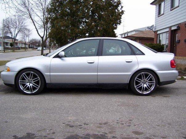

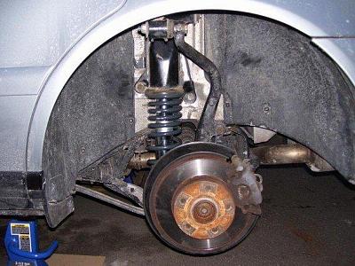

thats strange, did you install everything correctly? heres a pic of what my rear coilover looks like installed.
and this is how my car looks like first time letting it off the jackstands after the install.
installed like 3 years ago.
Attached Thumbnails rear coilover installation audi a4-coilover.jpg   rear coilover installation audi a4-untitled.jpg
