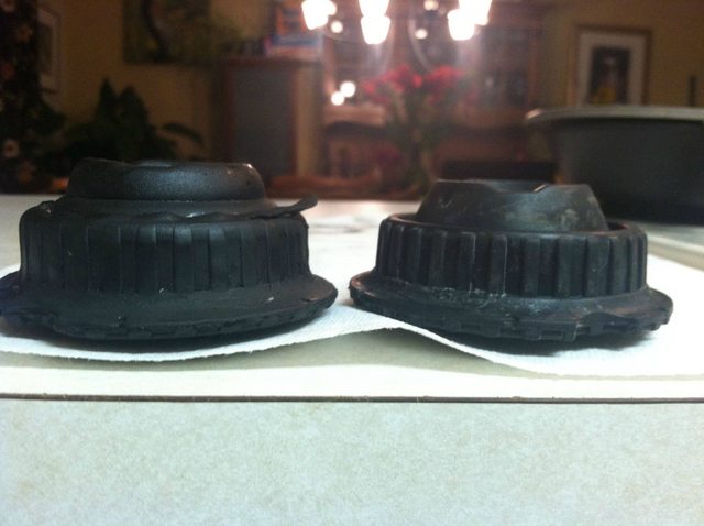

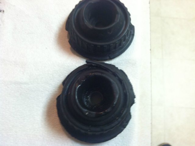

The old strut mount vs the new

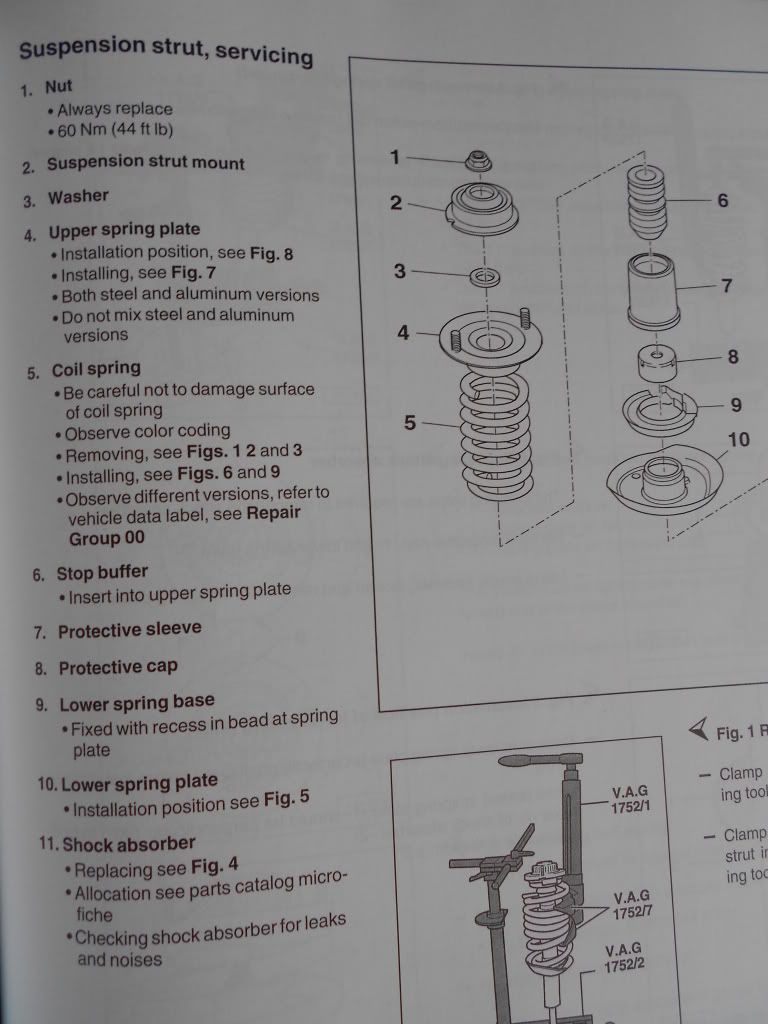

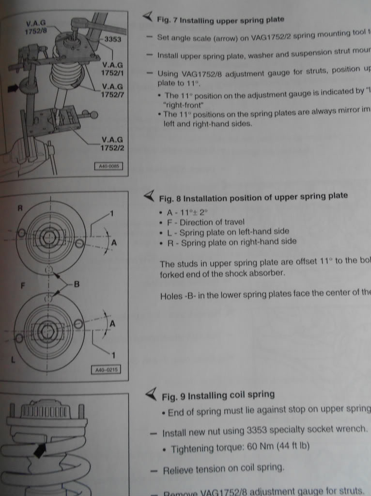

Hey so I'm guessing you figured out the rod spins when you try to untighten the bolt . So was the nut not on all the way? And man that shock bump mount is rough. I forget what kind of suspension you have? Anyways it seems like your doing everything right, I just hope that was your issue man. If it's not then??? New car? Lol. Oh One thing you should do is try and compress the shock while it's off. If it is hard to push the rod into the shock then it is still good. If it doesn't compress well or doesn't push itself out, then I guess you know a new shock is order. Best luck man. Here's some pics I just took from my Audi A4 bentley service manual. I just took the beginning 1st# and ending pages 3rd#. Maybe it will help?Name:  034.jpg
Size:  100.2 KBName:  035.jpg
