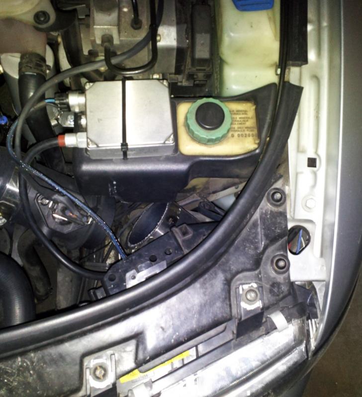

Preface: I've been running a blow-through MAF setup for 2-3 months now with the stock MAF in a 3in OD (2.75in ID) housing, with a catch can setup and custom cold-side intercooler piping.
This morning around 3:30am as I was driving back from my GF's place I got frisky with the throttle getting onto the freeway. As the boost increased there was a sharp pop and a harsh jerking of the car. The feeling is not unlike a bad misfire.
As I was driving I noticed there was no boost when getting on the throttle. Pushing in the clutch resulted in normal vacuum (21 in Hg for me), but still no boost. Driving back I was pondering in my mind what the issue could be.
I came to the conclusion an intercooler hose must have popped off, and based on my particular setup guessed that it was the pipe connector that connects to the inlet of the MAF housing. Upon arrival at my apartment my guess was verified! But this meant I completed most of my drive with my car acting as a naturally aspirated 1.8 without an air filter
With my wideband gauge I knew that the engine was still running like it should have been, around the stoichiometric air/fuel ratio of 14.7:1. SO: in this case the blow-through MAF setup saved me a HUGE headache because all air entering the engine was still metered Had my MAF been at the filter when the intercooler pipe popped off (this has happened to me a couple times before...) I would have been semi-stranded at 3:30am.

Heh all my stuff is clamped so tight I slightly deform the T-bolt clamps being used. The issue here is no lip on the MAF for the clamp to catch onto, and there was 25psi trying to force that silicone connector off . It took 2+ months for that silicone connector to finally works its way loose.
