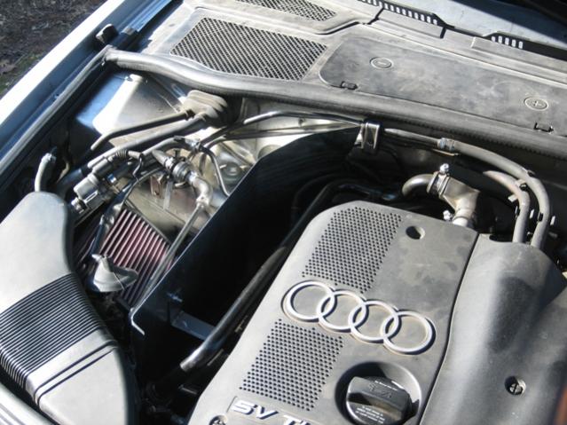

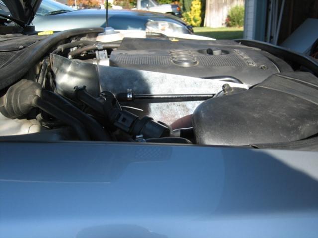

I went over to my local sheet metal shop and got a small piece of a thick gauge aluminum (I don't remember what gauge), brought it home and took a dremel to it.... I made a quick template out of cardboard first though. It was a quick 20-30 minute deal. It's not the best thing in the world, but I can I can pop the hood after a long drive and the filter isn't that warm. I attached a couple of pictures to give you an idea. Nothin' fancy.

did you attach any kind of heat prevention to it?
