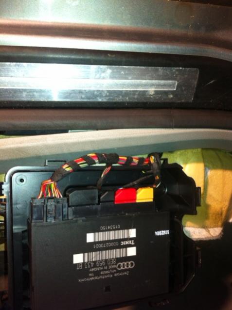

I was able to expose the comfort. I ran the fan on it the past couple of days. Fortunately I had another car to use. But my flashers are still going off. I want to disconnect the whole unit and take it out but for the life of me, I can't figure how to disconnect it. I don't want to break it either. Just want to see if maybe I can open it up to dry and clean it and then put back in. Do you know how to get it out?
