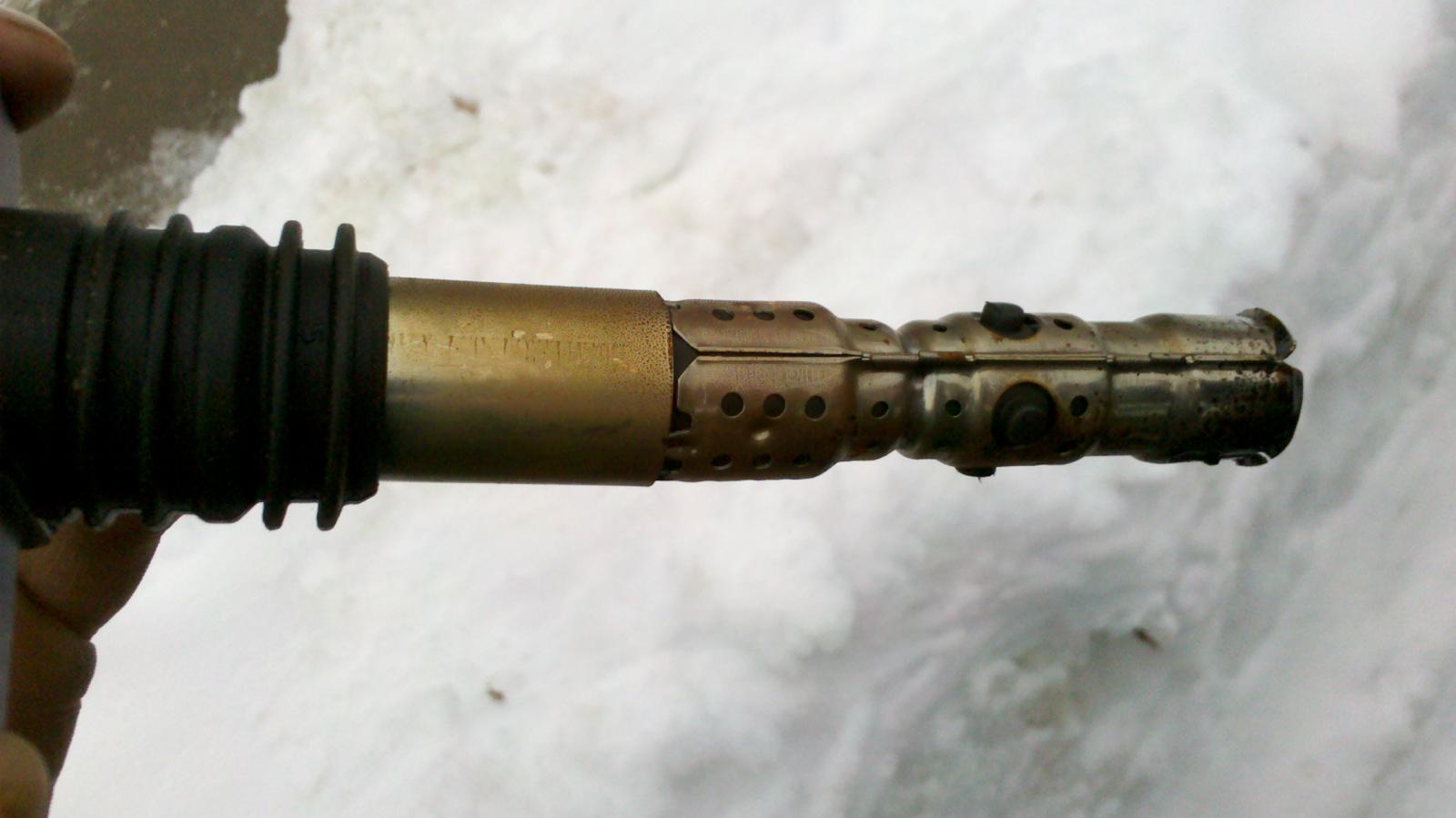

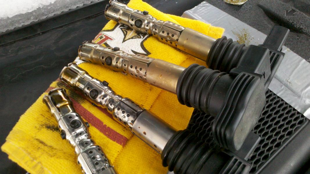

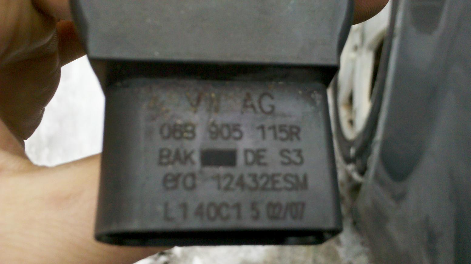

2. Bought 1 new coilpack. Going one at a time, I replaced an existing coilpack and turned on the car to see if symptoms were gone. After testing each coilpack the symptoms didn't disappear. (Please note only one coilpack was replaced at a time.)
3. Going from front of car to back of car, coilpack 1 and 2 were relatively clean, 3 and 4 were quite brown and looked very used.
4. I had coilpacks replaced about 4yrs ago, but i am not sure if they replaced 1, 2, 3, or all of them.

Change your valve cover gasket, then the spark plugs. Then take it to a dealership and they will change all of your coilpacks for free bc there is a recall. Also, you need to scan the car with an OBD reader and tell us what it says. Actually, scan it, clear it, drive for a day, and then if the CEL comes back tell us what it says when you re-scan it.
