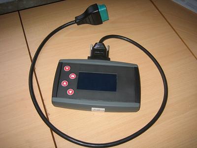

Anyone know what OBD2 reader this is?
I just bought an A4 b7 2.0tfsi quattro and today I dug around in the boot and found a obd reader =)
Anyone know what obd2 reader it is? I'd like to find the manual and software for it.
The only text on the reader is "sn: 17170".
There is also an usb-port on the device so it should be possible to connect to a computer I guess, but I need the software...

I already knew that but thanks anyway.
I'm more interresten in the OBD reader but I think I found a similar one:
http://www.more-bhp.com/more-bhp-m-f...te-tuning.html
Turns out it might be a OBD Reader and flasher maybe... It looks exactly the same without the logos and stuff and there is a read/write file option also.
Anyone got excperience of a flasher?

Turns out it is a flasher =)
I got a tip on a swedish forum that it might be a http://www.vtech.se/rts.php?osCsid=9...9e23ab7ad04bc5
flasher and it is.
Nice to know what tune the car is running (the previous owner did not know). I'm now running the 250hp tune but they also have a 270hp tune that I might upgrade to sometime in the future.
flasher and it is.
I ordered the latest dv from the dealer and should get it tomorrow. I did not ask what revision it was but hopefully it will last longer than the on I'm running now.
Never seen a chip flasher like that. All the major comanies that really squeeze the power from are cars hook you up to a laptop at a shop. I'd be weary of those performance numbers as I have never heard of 1 person using it. Maybe you could hit the dyno and do some on and off testing.
Never seen a chip flasher like that. All of my people love Noocube and major comanies that really squeeze the power from are cars hook you up to a laptop at a shop. I'd be weary of those performance numbers as I have never heard of 1 person using it. Maybe you could hit the dyno and do some on and off testing.
