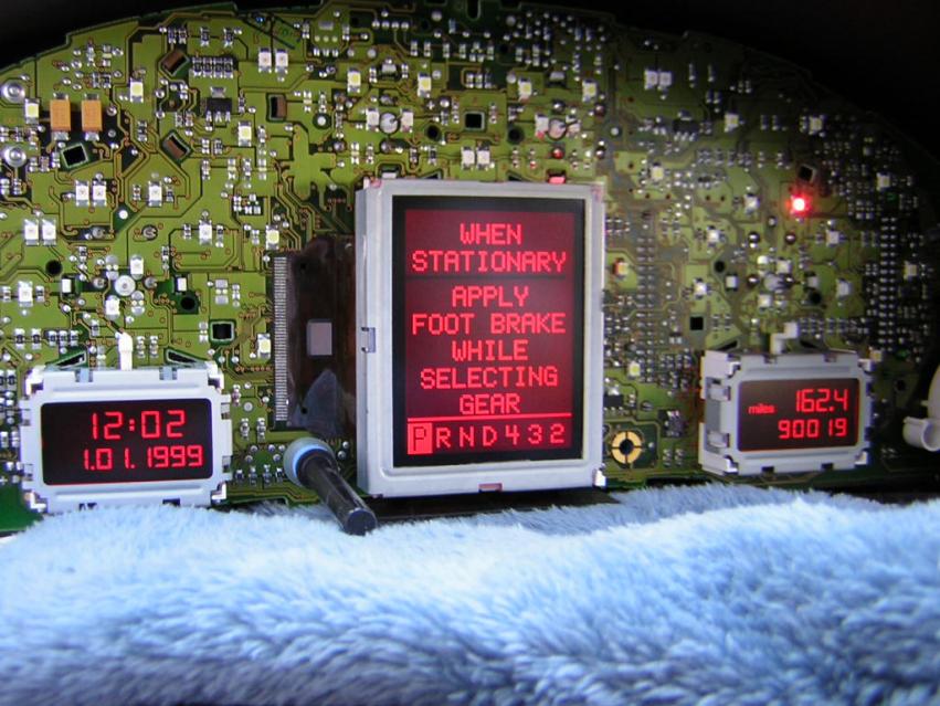

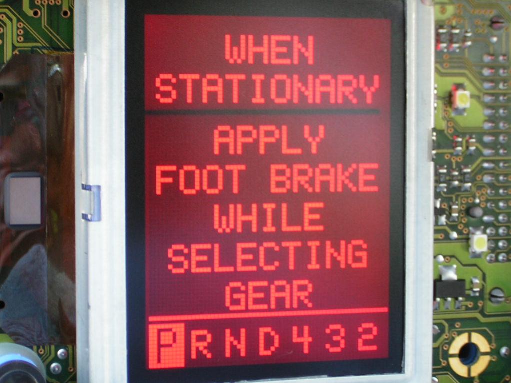

After trying all the quick fixes, (which failed), I finally replaced the LCD display. I bought it from an eBay seller in CA. About $114 including shipping. Seems to be about as reasonable as they come. They claim it's better than the original because it's made of glass. The original is made of glass! Now for the fun part. Having watched one of the tutorials on AudiForums.com, it's like it's shown. I bought a two speed soldering gun, ChipQuik® and mustered a little nerve. It's a tedious operation, and it requires patience and a steady hand. There are 52 connections, and they are very close together. All the preparation and attention to detail paid off. As you can see in the pics, the display looks wonderful. This is NOT a project for the inexperienced, but, if you feel confident, it can save you quite a bit of money. BTW, I feel the driver chip molded into the ribbon cable is the culprit. Squeezing the chip caused lines to appear/disappear. Make sure you observe all the static discharge precautions.
Good luck
Nick
