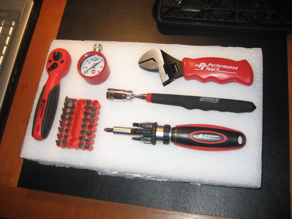

2". Use the box cutter to trim the sides until the piece fits into the compartment perfectly. Now you can lay out
your tools on the foam. Carefully press down on each tool enough so that they are stuck in the foam but able to be
pulled out. I basically stuck them in about half way. Once it's done it should look something like this.

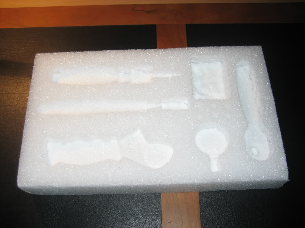

Now remove each tool making sure the imprints are clean and deep enough into the foam.

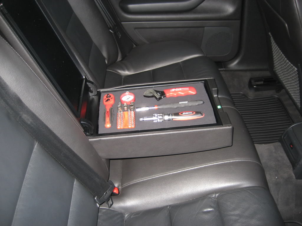

After allowing the glue to dry. Flip the tray over face down and lightly spray adhesive on the flaps and allow 10
minute to tack. Fold up each flap making sure they're nice and tight.

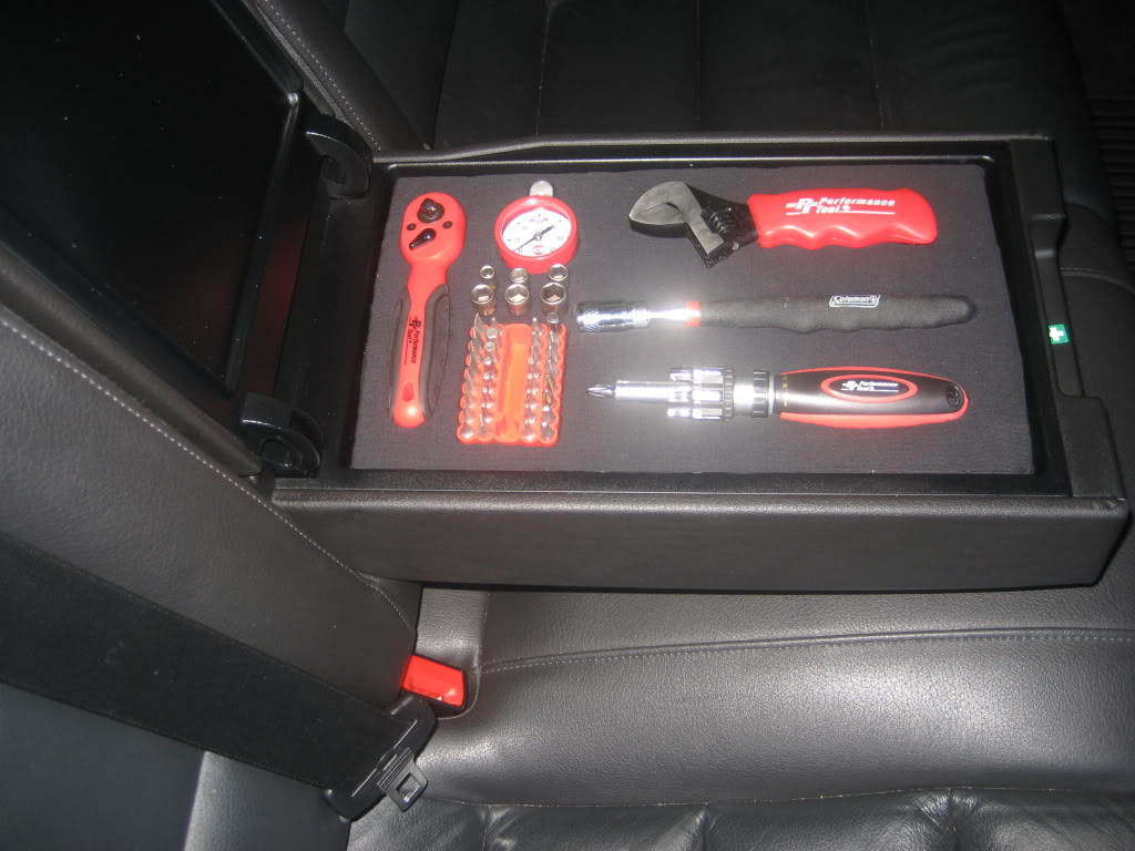

Allow the adhesive to dry and you're done. Install your which should look like this.

Nice idea and you did a good job creating it - I like it! If I didn't have a five year old and a four year old in the back seat, I'd probably do this. If I did it now though, my tools would be gone and I'd have Doritos or something in there instead
