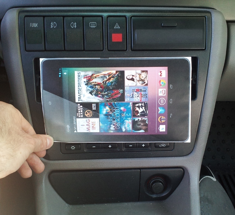

So this is a pic of my project idea for fitting the Nexus 7 into my center console, back when I first purchased the Nexus 7:

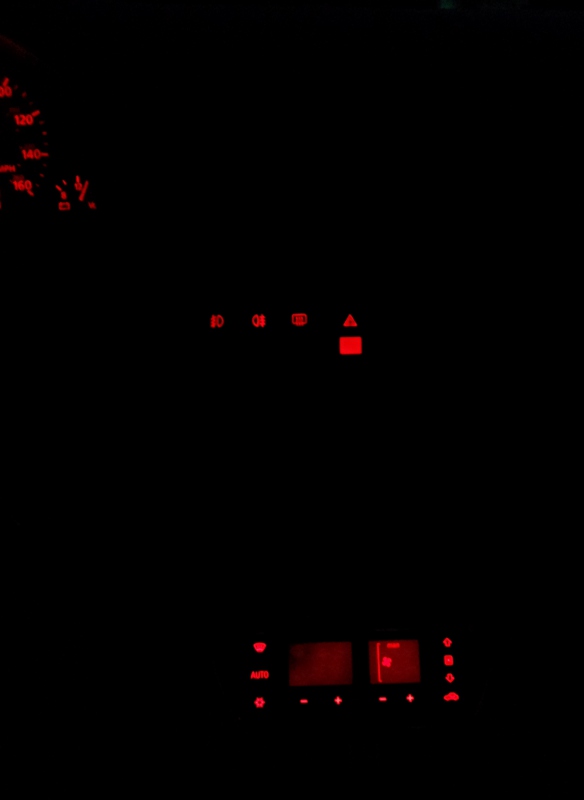

And here's a teaser progress pic
First person to guess what's "unique" about that picture gets an e-cookie
We have a winner
HVAC controller was relocated to where the ashtray/cigarette lighter are. Pics will be forthcoming.
