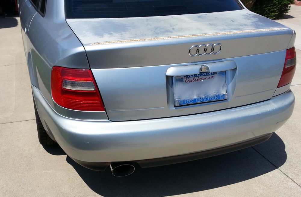

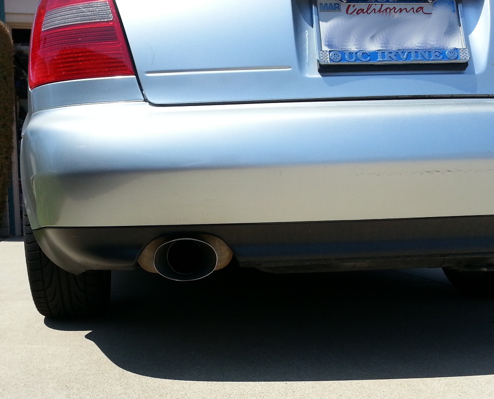

Anyways, back to my A4: yesterday my exhaust guy swapped out my ~2.5-year-old Magnaflow 14815 muffler for a Magnaflow 3"in/3"out/centered muffler. Had him install a 3" oval-shaped tip that fits the valence cutout moderately well. Already it sounds a little louder and in my experience mufflers get louder as the break in.
Pics and/or vids are forthcoming

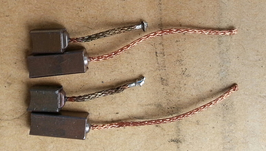

Tonight or tomorrow I may attempt to replace the brushes on my alternator. The voltage gauge in the instrument cluster usually doesn't read @ 14V when driving around, and sometimes it sags a bit. My battery is less than 1 year old.

Got some time in with my A4 again swapped out the old alternator brushes, that may have been original to the car. See the pic below, the short ones are old and the longer ones are new:

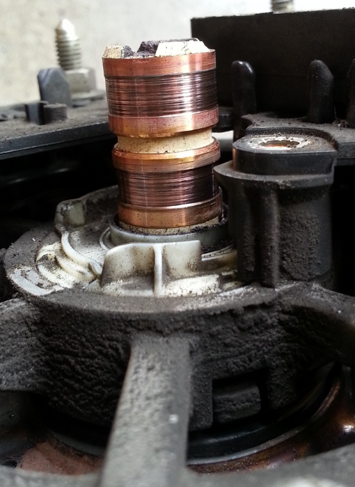

And the slip ring condition, before I cleaned it up (pretty good!):

So far the new brushes seem to help keep the voltage up, but I've only idled it thus far.

And just for fun here are pics of my new muffler and tip:

I wish the oval shape was a bit bigger to better fill the valence space but I'm satisfied for now.

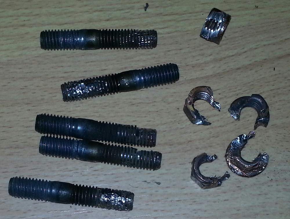

Had to stop for the day when I got to removing the FrankenTurbo exhaust manifold. I think I have about 8/13 of the nuts removed, but the last 5 or so are a real PITA to access. Will probably have to dremel those nuts off as a couple of them started rounding out when I tried removing them :/

Removing 12mm wrench-size nuts from a FrankenTurbo manifold absolutely sucks :/ I further cut-down my 12mm combination wrench, and was able to remove 2 more of the nuts, but there are still about 5 left. Two of them have been hit pretty hard with a Dremel, but those nuts still aren't budging yet (and their respective studs will need to be replaced). Gonna tackle them again tonight some more. Wish me luck!

FINALLY got the FrankenTurbo exhaust manifold off last night. All totaled, I think it took me about 5-6 hours just to remove the nuts holding it in place. Thought I'd share some of the Dremel carnage that was necessary to remove 5 of those nuts:

I'm gonna put anti-seize on the replacement studs, for sure (even though I'll probably never be the person removing them again).

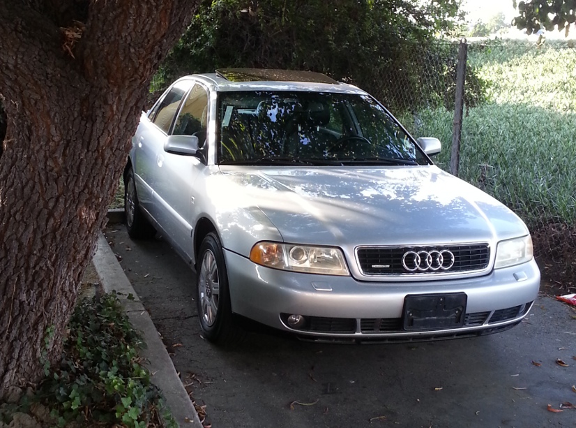

Also thought I'd put up a pic of the 2001.5 A4 1.8TQM in all its monster-truck and yellowed-headlight-lenses glory:
