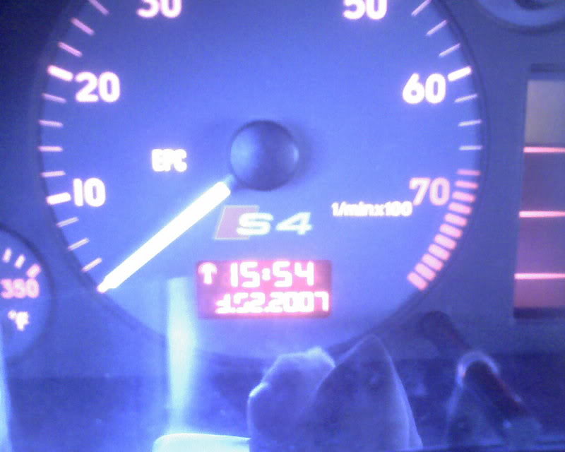

alright guys well i hooked up my vag com to my audi today and i wanted to change the clock from US (12 hour) to german or rest of world (24hour).... it changed but some of the pixels on the screen with kind of f***ed up.. actually it didn't even look like it was numbers..
what do you think it might be. or is there a different code?

I havent played with any of that stuff but i dont see how a code like that could make pixels suddenly not work...

yeah i dunno, i did the code on my friends vw gli, and vw r32 and everything changed for them perfectly.... im just going to go back and forth maybe something will start working..

is there some kind of diagnostic you can run on the screen to refresh the pixels. maybe there not working correctly becuase they have NEVER been turned on....

Codes are specific to the car. I would change them back & see if it resets back. Yes, putting in the wrong code can & will cause weird things.
Ross-tech has all the proper codes for our cars.
