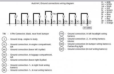

I'll attach a listing of the grounds on your car...
When you have all the short to ground codes for various components replace the PCM relay in the box under the wiper cowl. There are two identical realys and I always replace them both. The relay control ground side drops out momentarily and causes these codes. I've done these many times over the years. If you look at the wiring diagram you will find that the relay feeds all the components with the faults. Only buy OE relays form Audi.
