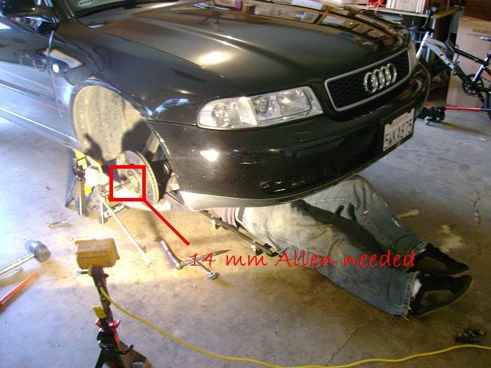

1) loosen 17mm alen bolt that connects the axle
2)loosen lug nuts
3) jack up car and remove wheel

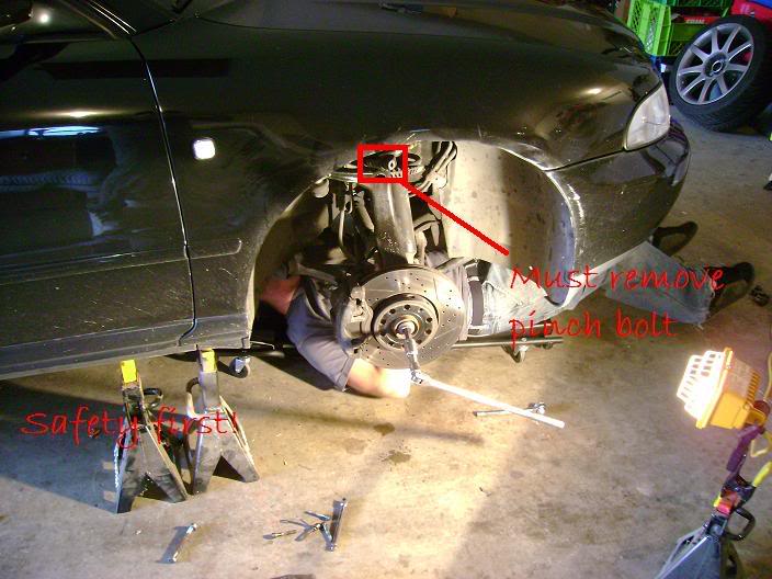

4) remove 16mm pinch bolt using 16mm wrenches or sockets

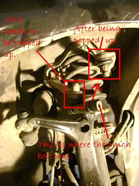

5) with a rubber mallet tap connecting arms up until they come up loose from the pinch "deal"
6) using a 8mm tripple square remove the 6 bolts holding the axle to the trans.
7) pull the abs speed sensor straight out
8) strat loosening the 14mm axle bolt, then tap it in (pushing the axle in)
9) bend the joint of the axle and remove.
-now repeat everything in reverse....

I think i might add, that its a 17mm allan bolt, not a 14mm axle nut.
Old Jan 29, 2008 | 12:39 AM
qUaTtRoA4's Avatar
Joined: Dec 2006
Posts: 1,953
Default RE: Partial half a$$ed CV axle DIY *pics*
ORIGINAL: auditech79
thanks, I fixed that above...I thought it was 14mm, but couldn't remember because it was a tool I had to borrow and no longer have. and hopefully wont need for another 10 years.
