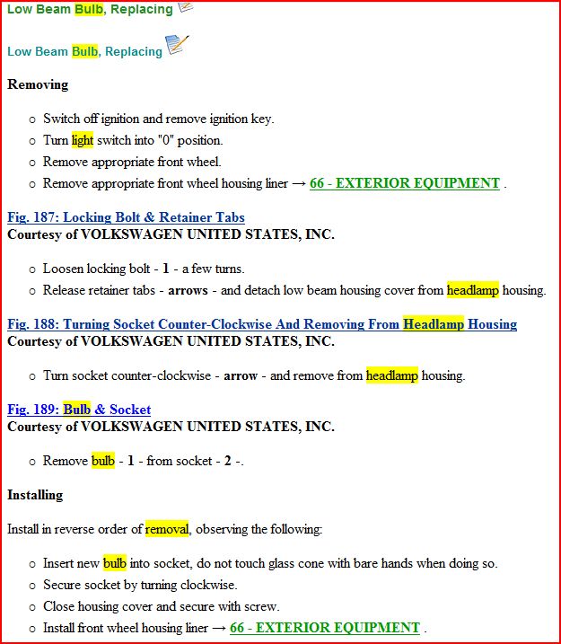

As a general rule with HID bulbs, switching the bulb with the other headlight will eliminate other problems...letting you know if it's the bulb or an igniter or ballast.
Not super easy to get to, but doable without bumper off i believe:
