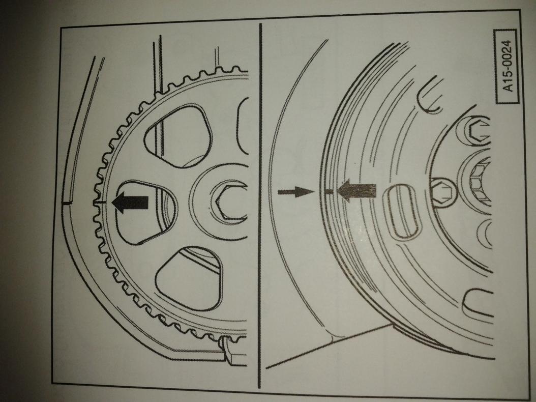

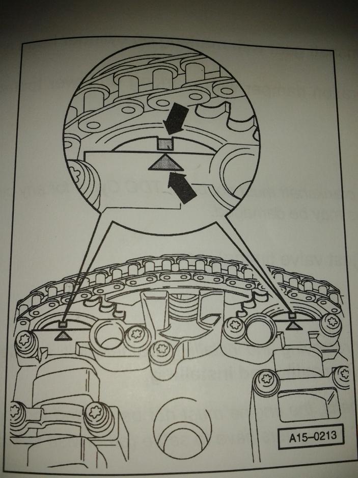

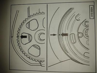

so the first picture shows both timing marks on the valve cover (top) & crank (bottom) basicsthe second one show's how to realign camshafts if taked out.

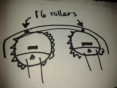

has triangle mark on cam cap, rectangular mark on cams. and 16 rollers in between marks with the exhaust ending off by a bit to retard it or something like that??
k so i did all that for the exception that i didn't go with a stock cam sproket, was but it broke because i wasnt carefull... long story short i bought and autotech adjustable cam sproket from 034 Motorsport =D
the only thing was. i was able to align it like the bently book says (bottom pic from above) but when i put the valve cover i saw the marking on the new sproket was off by a bit i'd say 2-3 teeth advancing it?? even though it was adjustable it was still on stock mode. so what i did was just turned the camshaft sproket bolt till it alight with both marks outside but would that explain the lifter noise?? & its not the valve hitting the pistons cuz i double checked. hand cranked it several times (2 revolutions everytime) so i know thats not it
any imput?? does the internal marks cam cap, camshaft, roller & valve and cam sproket have to be all aligned together ??
because the car starts just making the lifter noise and as far as i can see both the crank & cover + sproket marks are aligned

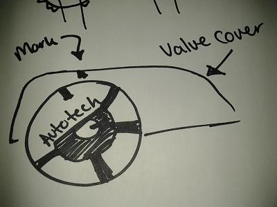

hey a drawing lol
the one to the left (1st one)
is with the internal cylinder head timing marks
second one is with what my autotech sproket looked like once cover was on
notice its a bit off??
what am (or was) supposed to do in this situation?

so got done rebuilding my driveline yesterday!
with that i had the valve cover open to check all the alignment marks
cam to valve
crank
internals (all 3 marks on camshafts & 16 rollers)
everything lined up as it should
i gess my autotech was a bit off but it retarded itself into the exact correct position. i aplied some fresh oil and assembly lube to the camshaft and what i could reach on the lifters and assembled the cover back on. made sure all sensors and wires were connected and started the car
