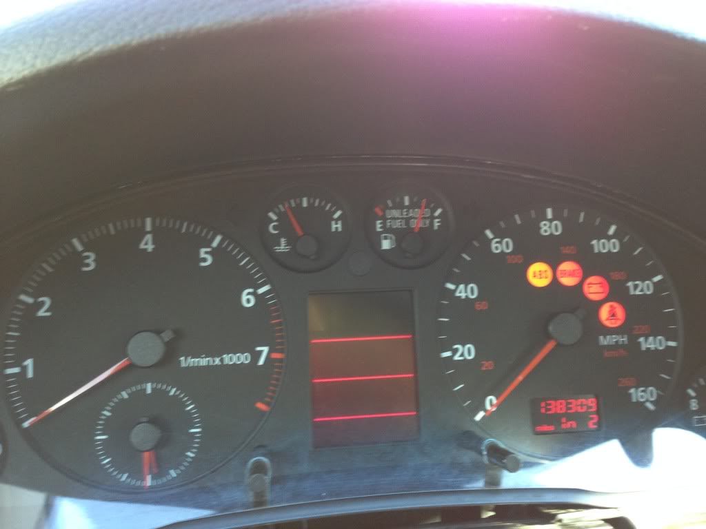

Alright, got the stalk hooked up. From pin 1 on the stalk (grey wire) to pin 11 on the cluster, pin 2 ground, pin 3 (green wire) to pin 14 on the cluster, pin 4 (blue wire) to pin 18 on the cluster. I switched the ambient temperature sensor from pin 3 on the old black plug to pin 5 on the new one. Put it back together to see what I'd get. Nothing still, not even the outside temp?
So after this I only have the fuel consumption signal (from ECU), selector level display (is this for auto trans.?), coolant level, radio clock, enable & data, and lights. And I don't have any backlighting for the new cluster? I see on the old one it was pin 4 on the 10 pin plug.
When you tested it did you have the blue and yellow plugs connected? They should be. Coolant level can stay in the same position, pin 20 on the blue connector. It should activate the low coolant warning in the original position, but I suggest you test it.
The cluster illumination power is in blue/yellow plugs. No need to move the power wire going into the black 10 pin.
Selector display is for auto trans only.
I didn't hook up the three radio wires since I have an aftermarket head unit. I grounded out the bulb out warnings.

Clayson's Avatar
Joined: Jan 2012
Posts: 214
Yeah, they were all plugged in. Maybe the lights are bad, I'll try switching some good ones over from the old cluster.
