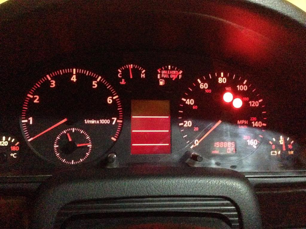

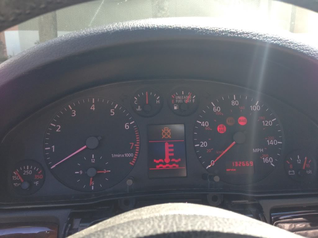

Hahaha.... Hooked up a cluster from a "98 A6, I knew it wouldn't work. I think I'm the most bored college student ever. But the results were funny to say the least. What did I get? A CEL that doesn't know if it wants to stay on or off, a brake light that stays on, brake pad wear sensor warning, coolant level warning, a fuel gauge that think I have WAY more gas than I do, oil level warning, no tach, lights that stay on, ABS light, AirBag light, and oddly no A/C condenser. Oh and VCDS wouldn't detect it either. Is this what I would get if I put in a '98 A4 cluster?

So... got a DIFFERENT cluster. It's doing the same thing!! It lights up, but won't display info. I emailed Ian to see what he says. I think God's just pissed at me or something.

Old Oct 19, 2013 | 01:53 AM
  #74
BaseDrifter's Avatar
Site Moderator/B5 Tech Guru
Joined: Feb 2010
Posts: 1,745
From: Bay Area, CA
You should start looking at your wiring for the red plug. Double check that you have the pins in the correct locations, make sure the wires aren't damaged, etc.

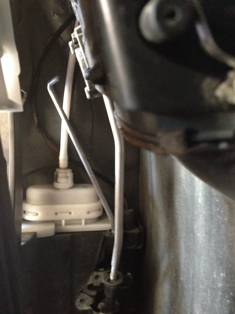

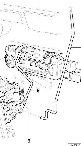

Does anyone know what this is supposed to attach to? I started to hear it whacking the window inside the door whenever its down.

Old Oct 26, 2013 | 06:39 PM
  #80
mtroxel's Avatar
Joined: May 2012
Posts: 1,272
From: Minnesota
Does the outside door handle still work on that side?
