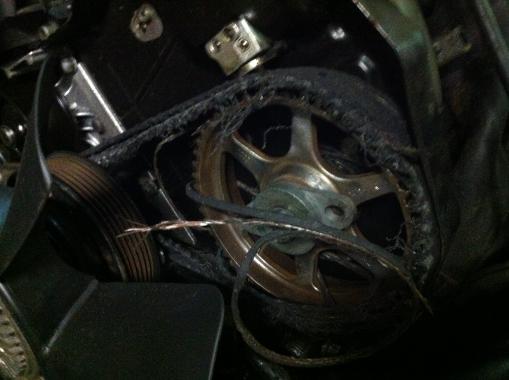

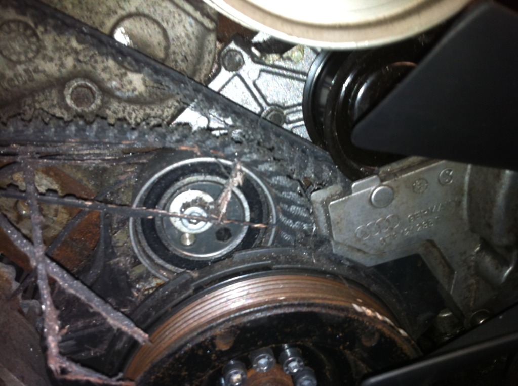

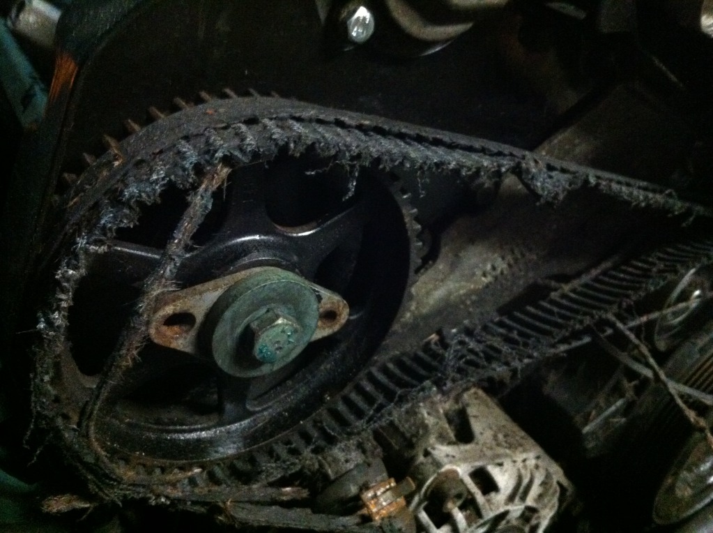

Well everyone I found out my issue... I am kicking myself in the *** for this right now. After I had finished the timing belt job, I started the car up and it started fine. I let it run for a couple seconds and then shut it off. I haven't started the car successfully until then. Today I was fiddling with the car trying to figure out why it wouldn't start. Out of curiosity, I pulled off the toothed belt covers, and to my dismay, I found that the belt was almost ripped to shreds but was still in one piece. So I took everything off to take a look and found that I put the toothed idling pulley on backwards and caused the belt to partially come off the pulley. I'm so mad at myself right now. But anyways, I would like to know how you put the cams in the correct position when they go out of time like this? Do I need to pull the valve cover off and check visually?
This is what happened to the belt...
