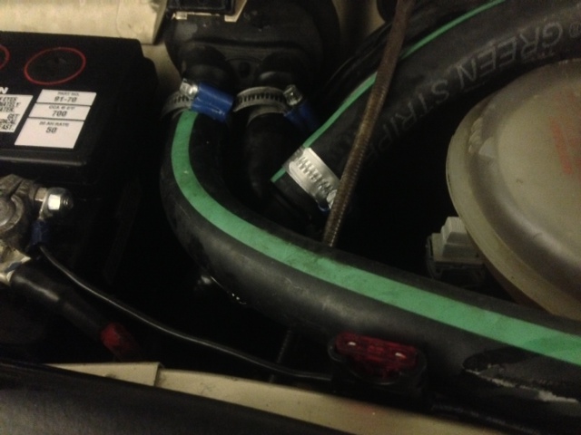

I extended my heater core hoses

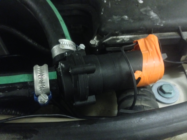

I got a 12 Volt Auxiliary water/circulation pump (you can use the ones from Audi, or in my case, I got one from ECSTuning for a MERCEDES because it was VERY cheap ($25 or so)
I put some mesh on the in side/in-let of my heater core so gunk wouldn't block the heater core again (see below as to why)
Hooked the pump up to my extended heater core hoses (I put the suction side of the pump to the OUT side of my heater core....)
Wired up a toggle switch 1st to the inside of my car to test it
It worked, and heat was working flawlessly...WTF? Right?

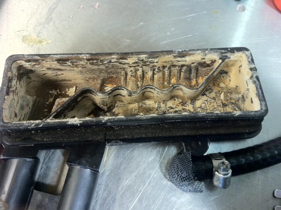

Best guess....you ready? Previous owner probably put stop leak in the system (hence the mesh screens) I HATE any KIND of STOP LEAK!! IT should be ABOLISHED!!!!! NEVER USED IT AND NEVER WILL!!!!...yup...and the little 90 degree elbow that comes off the coolant line on the back of my 2.8 that goes to your heater core inlet....well, it's got a bend in it and it's tiny...it was getting blocked by old stuff/gunk floating around in the engine, EVEN after over 20 POWER flushes....and clear water coming out......story's not done yet.....

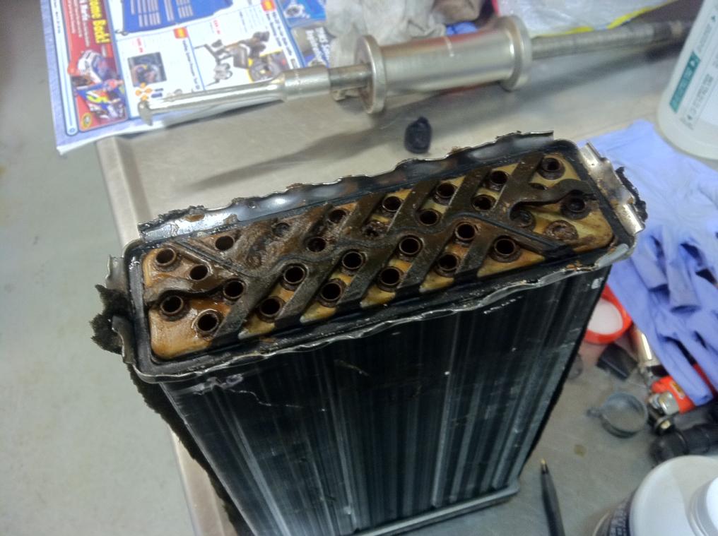

Once the pump was working I had heat, so I drove around for a week, then decided to take my Inlet side of my heater core hose off and check the screens.....had some gunk on it, so I put my finger down the hose and pulled out a chunk of OLD stop leak....funny huh? Then, I put new screens on drove around for another week, checked screens, seemed fine...took my pump off, and my heater now works NORMALLY!!
I'm attaching photos of my pump setup as well as photos of my old heater core...and yes, you CAN laugh......but THIS is what ANY KIND OF STOP LEAK does to your HEATER CORE!!!!!

Radiator IS new as well...I forget to mention all the S**T I've done to this car....Oil crap done too...I could've bought two BRAND new audi's the parts I dumped into this one...stubborn me....Originally Posted by mtroxel
Nice work Marky. You've had a fight. I've bought a few flipper cars with stop leak in 'em. I think what happens is that someone tries stopleak, they still have a leak so of course the solution has to be.........................another can of stop leak.Obviously you have to suspect your radiator now. But don't forget your oil cooler. I had one of those full of the crap once. Couldn't even blow through it.
