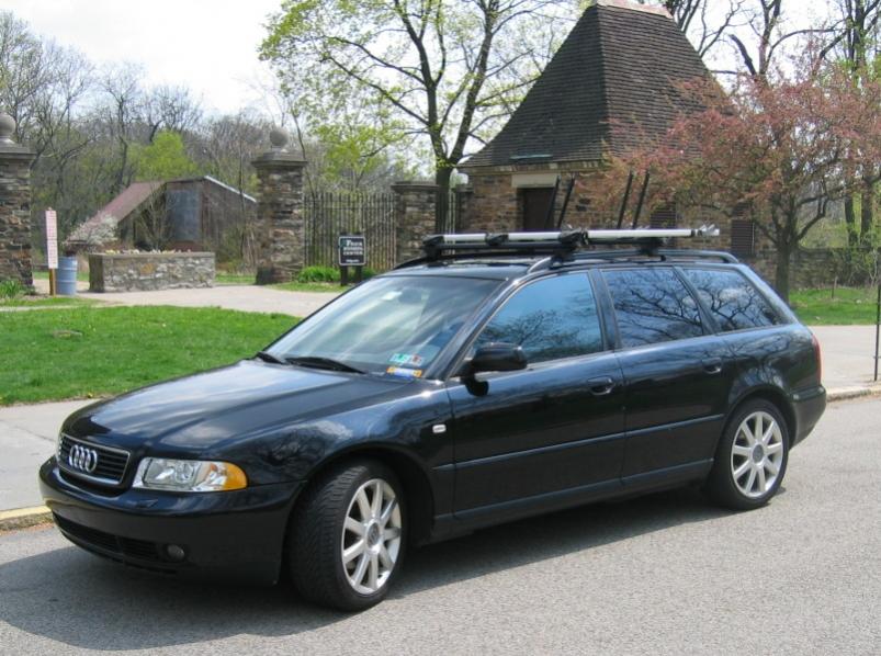

I would probably have around 4-5 grand to put into it, and pretty much no technical experience. That's why I ended up going with the APR guys b/c they gaurantee all the work and they are nearby. Only negative thing is they seem to sell everything together which makes it pricey. OTOH this seems to be better insurance against things failing from incomplete mods, right? They have done right by me up to now.
Not looking for huge power increases, just a daily driver that can get me around traffic, and not get walked by late model grocery getter SUVs and still keeps decent mpg.
Already have the sport suspension, so hoping not to put much into that area until replacements/repairs are required. Also not looking to do exterior mods, want it to look stock.
