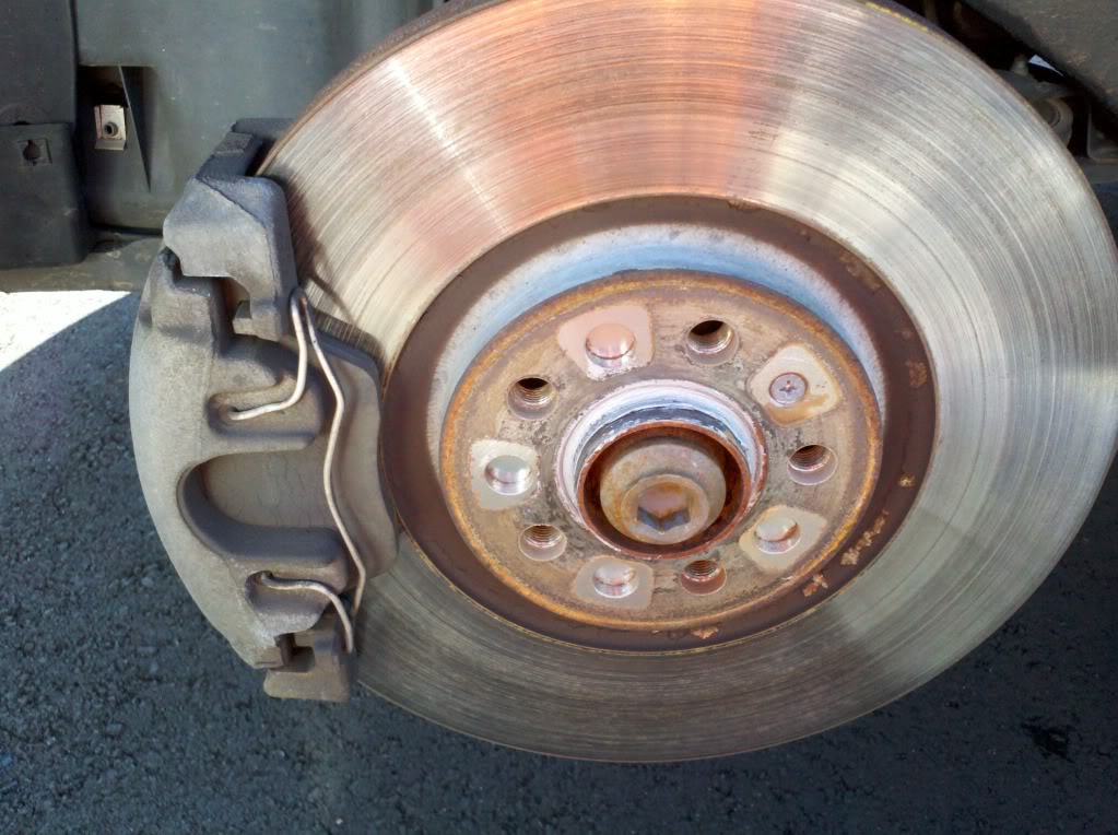

Before. These look original. Rotors and pads were OEM parts.

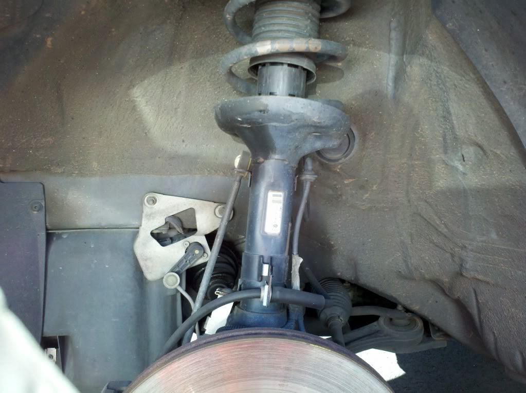

Weird suspension on this thing. No four-link like ours. There's a big *** A-arm on the bottom and not much up top

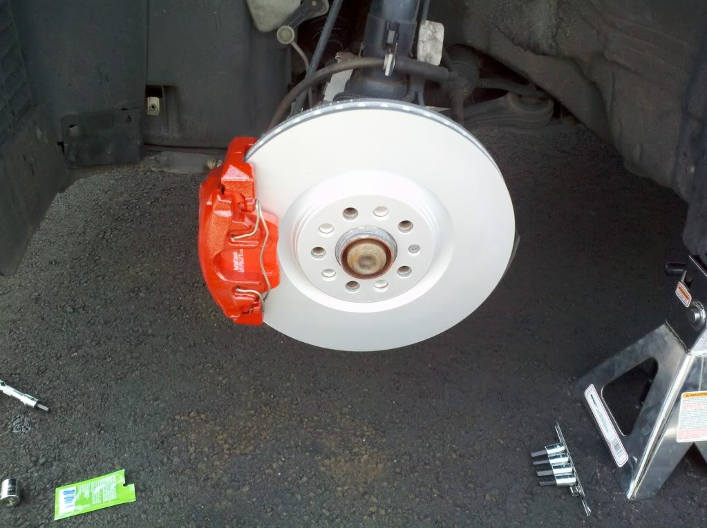

Driver's side front when I was done. The lady wanted red brakes, the lady gets red brakes
Another shot of the calipers with the wheels back on.
