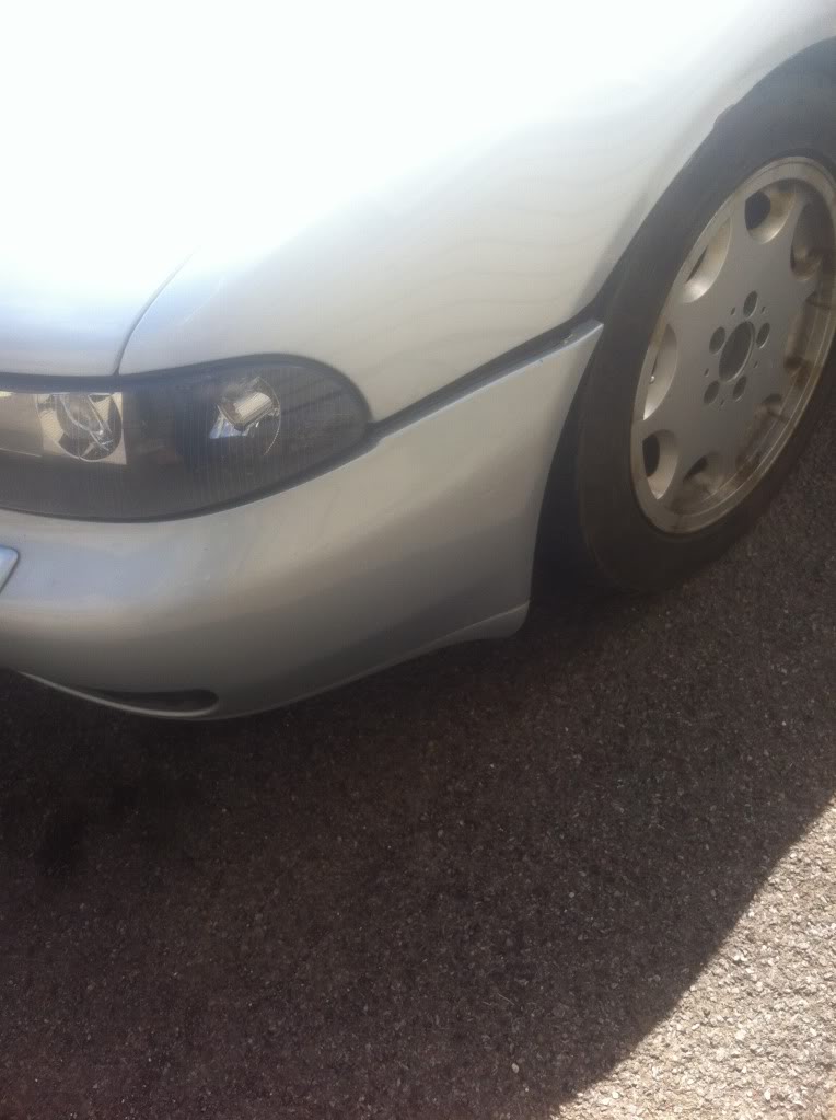

I did a quick fix on my car that's been pissing me off. I damaged the side bumper bracket on my car awhile back and as a result the bumper would droop down if I hit a bump, kinda like this:

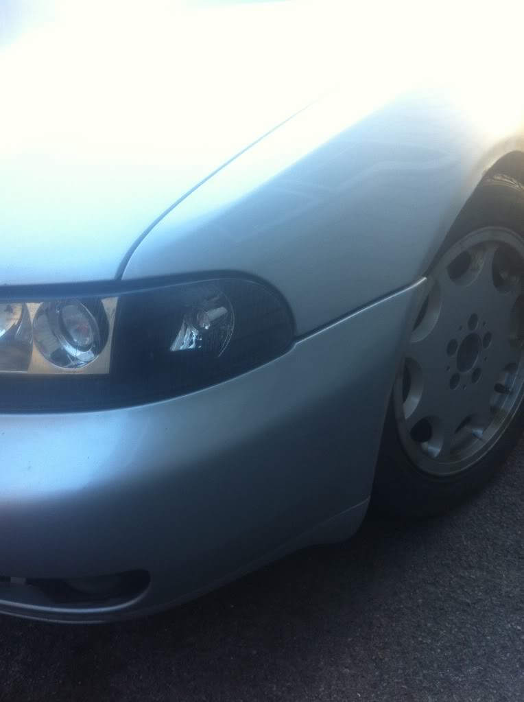

I just went out, took out the big bolts behind the fog grilles that go into the bumper shocks, slid the bumper forward, and removed the bracket. The lower guide was weakened. I put on a bracket I pulled at the junkyard last week and put it back together. Now it sits like it should. It's the little things that matter sometimes.

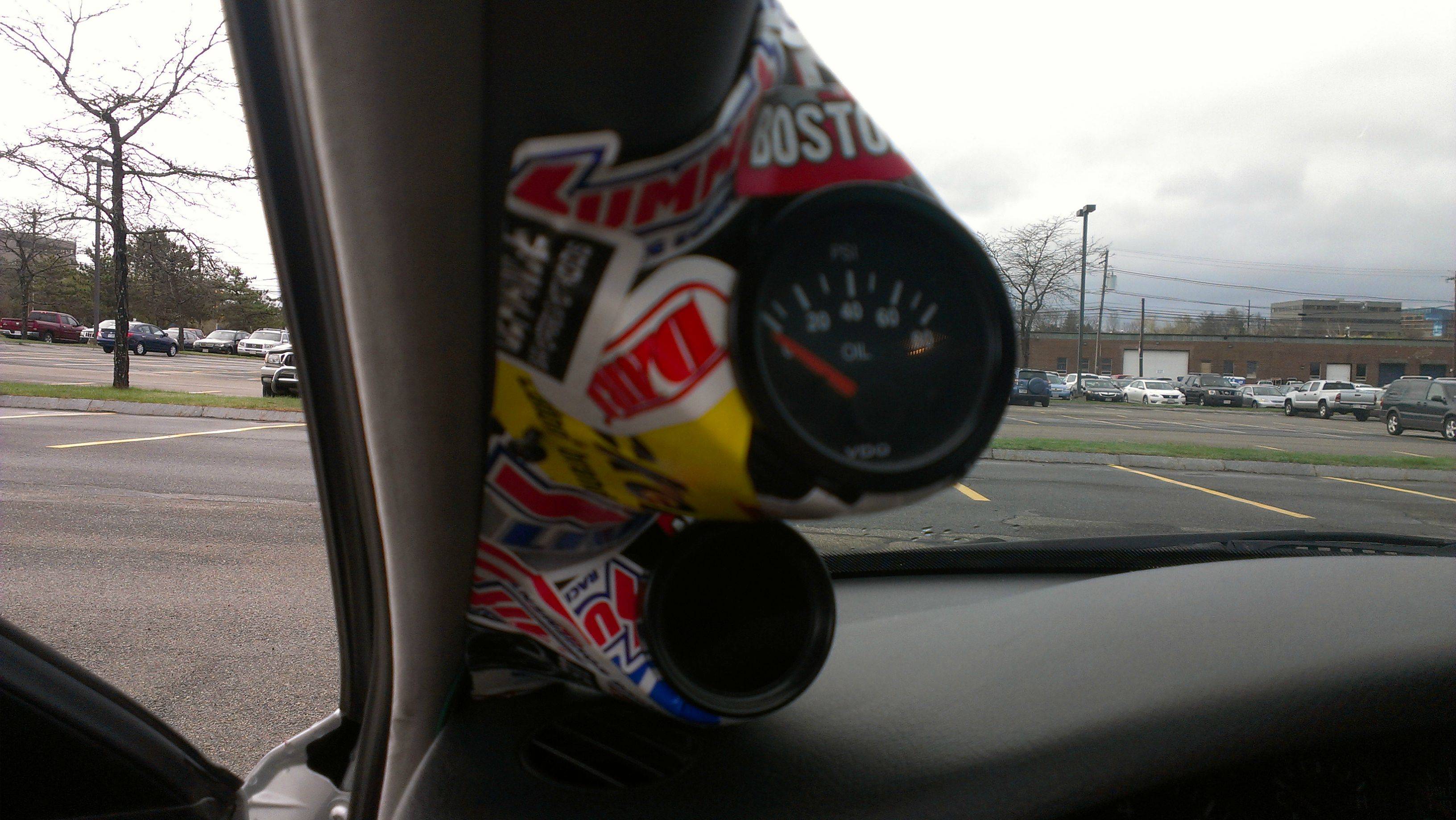

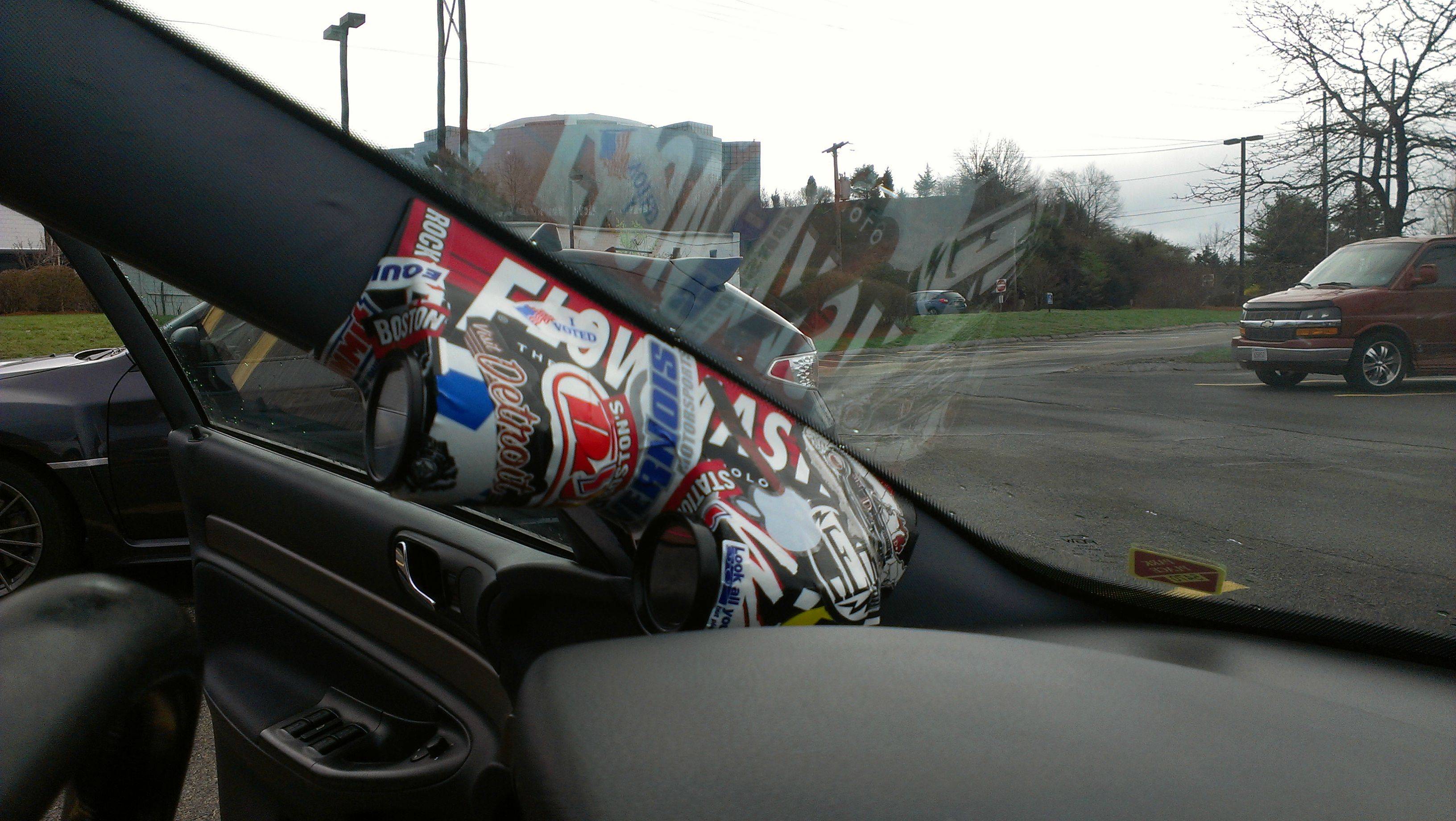

I sticker bombed my gauge pod. What do you think? I want to start doing major fixup work to my car, but you gotta start small, right?

Not my style personally, but whatever blows your hair back
