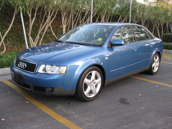

I have my eyes set on this blue 2002 A4 1.8 automatic below.
It has 59K and asking price is $12k.
I'm not new to cars (founder/editor of FordMuscle.com), nor to turbos (have a Volvo V70 T5). But I am a complete newbie to Audi's.
I'd appreciate your advice on what to look for when buying a used B6 A4. I'm looking at cars under 70k mileage... what problems might I look for?
I'd prefer a manual 5 or 6 speed, but love that blue/gray combo and so far only two that have popped up in my are are auto's. I plan to APR chip the car...any disadvantage to auto or manual when it comes to chipping?

Anyway, I'd highly suggest holding off for a 5 or 6spd car. The main things to look for is if the previous owner has done the maintenance. These cars need synthetic oil changes with the large filter (m1-301 filter, same as 5.0's use) every 3-5k miles. Also plan to have the timing belt/waterp ump service done around 75-90k miles. I just had mine done and i'm at 83k.
They are really fun cars to drive and make great daily drivers, especially having the quattro. They handle awesome.
