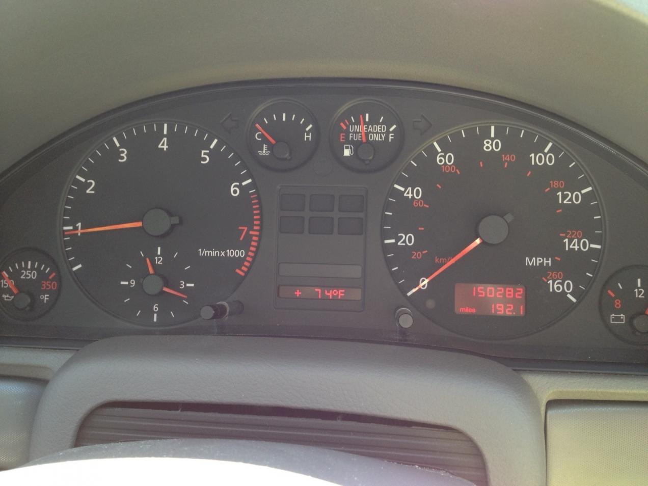

Finally, once I got that straightened out, I hooked her up, and sure enough: my ECU was coded for a FWD automatic. I have a 5 speed quattro. So I changed a couple numbers, (thanks for that MetalMan... huge help) and the CEL cleared itself, and has not returned. I also cleared the Airbag light while I was in there. So, this is what it looked like yesterday on my way to the golf course:
