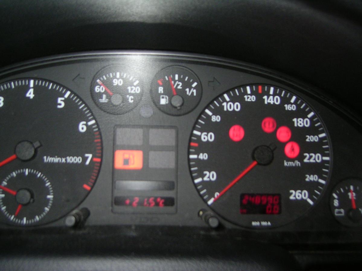

Originally Posted by Dallas09
Does the check engine light come on when you turn the car to on?
Good Catch Dallas09. I just check and NO the check engine is NOT on. Any Ideas?

From: Minnesota
That basically means no power to the ECU, so check fuses relays, connections etc., otherwise from what Ive read, its either a bad chip (if you have one) or a bad ECU.
